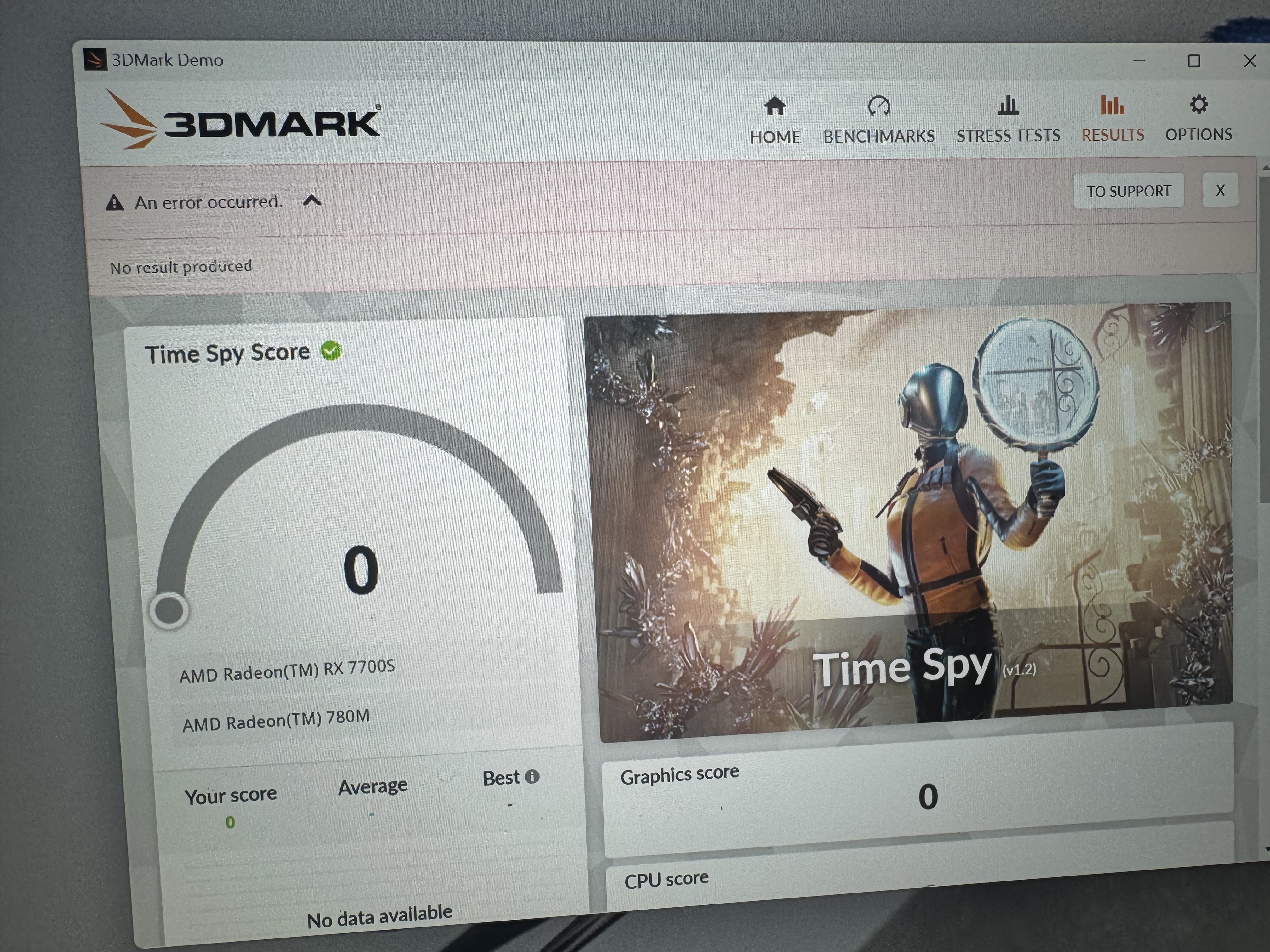

3D mark issues “no results produced”. I was trying to run 3D mark on my 7700s, but is not working, does anyone know what happened?
Are there any log files that you can check?
Also have you installed the latest drivers + BIOS updates?
That is true, is the latest version of drivers and bios. Sadly there is no log file this time it just say “no result produced”
Problem solved, just switch the graphics setting on AMD software to ”hybrid” mode
One thing to note about hybrid mode is that it won’t give you the full performance of the dGPU. This is because the frames rendered by the dGPU will still have to go through the iGPU unlike with a MUX where it is directly hooked up to the internal display.
If possible, have you tried seeing if you can change 3D Mark in AMD Adrenaline to run on the dGPU only (High Performance mode). I believe you should see your display freeze for a second before it shows you a notification on the top right of your screen that says it’s using the dGPU to confirm that you are using the MUX and the dGPU for maximum performance.
Will, I believe it has shown all performance as I got 10535 at the end, which is a relatively good performance I believe.
