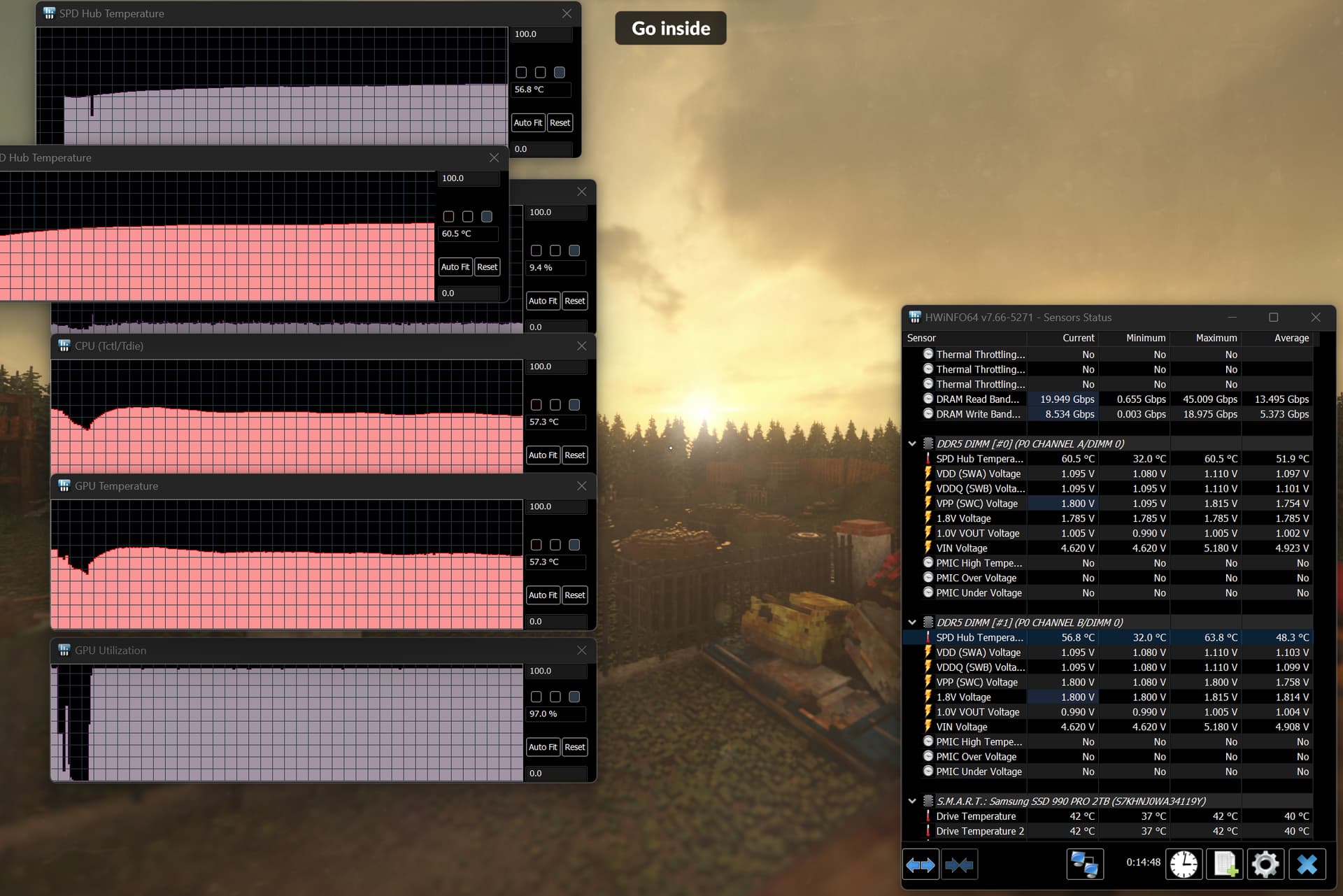

Not seeing anything to worry about here fans weren’t even going hard. 2x16gb crucial 5600 cl46
literally any load on the gpu does it, now i cant really show it throttling because it has the thermal pads and thermal paste on the ram (plus the thermal paste kinda glued the ram to the board so i cant retest it without it lol) but this is what i managed to get it down to

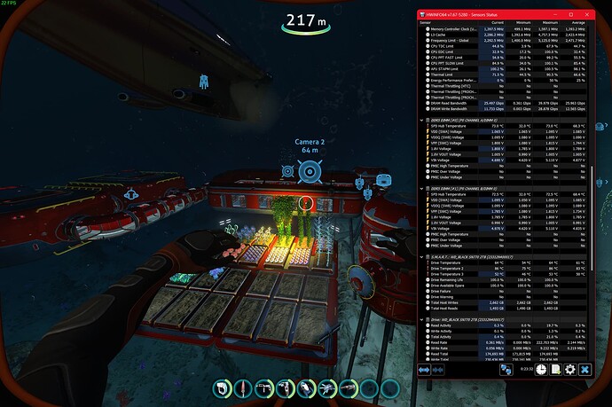

Trying out that game benchmark you mentioned at high I got my 2 sticks up to 74.5 and 69.5 degrees Celsius at max temp. When in cinematic mode directly afterward the 2nd stick got up to 69.8 degrees Celsius.
Apparently this never got updated to acknowledge that Windows 11 exists though as it assumed I was running on Windows 10 (I am not).
