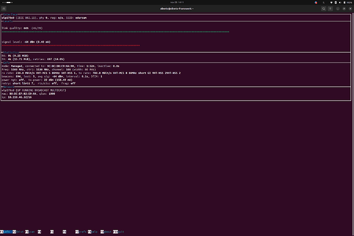

If you are trying to troubleshoot wireless connectivity issues, two tools every Linux user should know are wavemon and iperf3.
Wavemon will give you a detailed readout of what the active connection physical properties are, actual phy rate, disconnect/ reconnect, etc.

That all being said, my own investigations in using the FW supplied antenna brought up some interesting points:
  • The FW antenna isn’t exactly amazing even in free air outside of the laptop case
  • As a client STA, the FW antenna is highly sensitive to orientation towards the AP. Even ~10 degrees in alignment change can nearly double throughput, especially at higher phy RX/TX rates
  • As an AP, the FW antenna loses ability to serve clients much more rapidly than a reference 2dbi omni stub style antenna
So the lid doesn’t help, but the FW antenna design itself definitely deserves some of the blame here.
