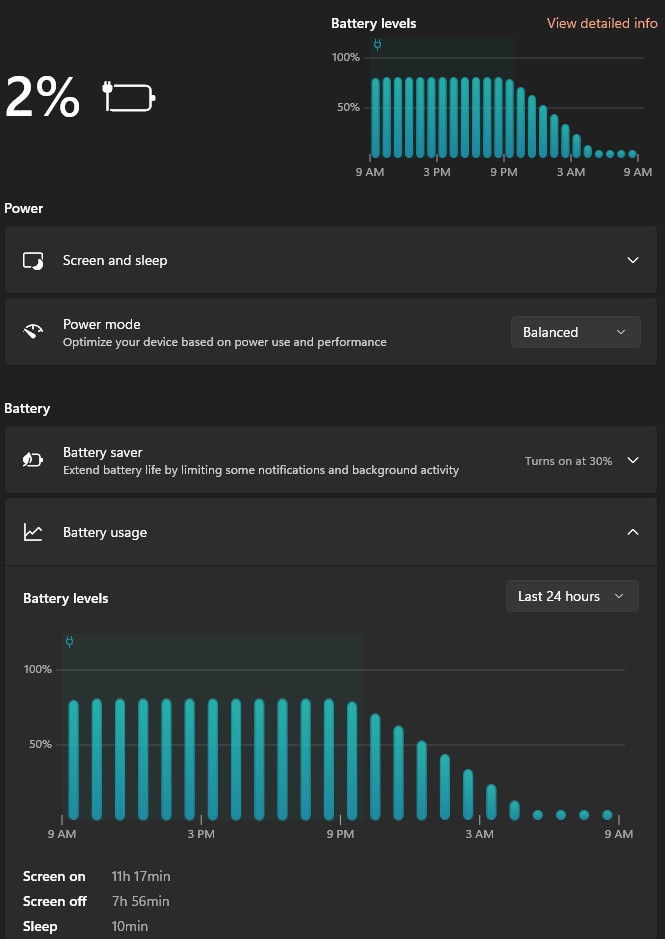

Has any permanent solution been found? I’ve had my laptop die overnight a few times this past week, and today it was at 1% before I could plug it in.
No peripherals attached. Windows 11.
Didn’t have this issue for at least 5 weeks after getting the laptop, so this has just started with no changes to my system.
3h of charging, and it’s still not at 85% (the charge cut-off I set in the BIOS), so the battery was as low as it stated.
Original charger and cable, but it seems that the windows battery status ā€œfrozeā€ as it did reach its expected charge in just over an hour.
No excessive heat during charge, and I do use my laptop while it was charging.
I don’t think there’s anything wrong with the charger/battery, but something causes it to drain overnight from time to time, as per the rest of the thread.
The power light was flashing red when I opened the lid, and it showed 1% along with the battery chart in windows showing the drop, so I assume I did.
This happened only twice, and it’s been generally pretty consistent with nighttime drain, which isn’t usually a problem.
I will note that while I don’t have any connected peripherals attached overnight, I do still keep 2 x USB-C and 2xUSB modules attached to my laptop.
