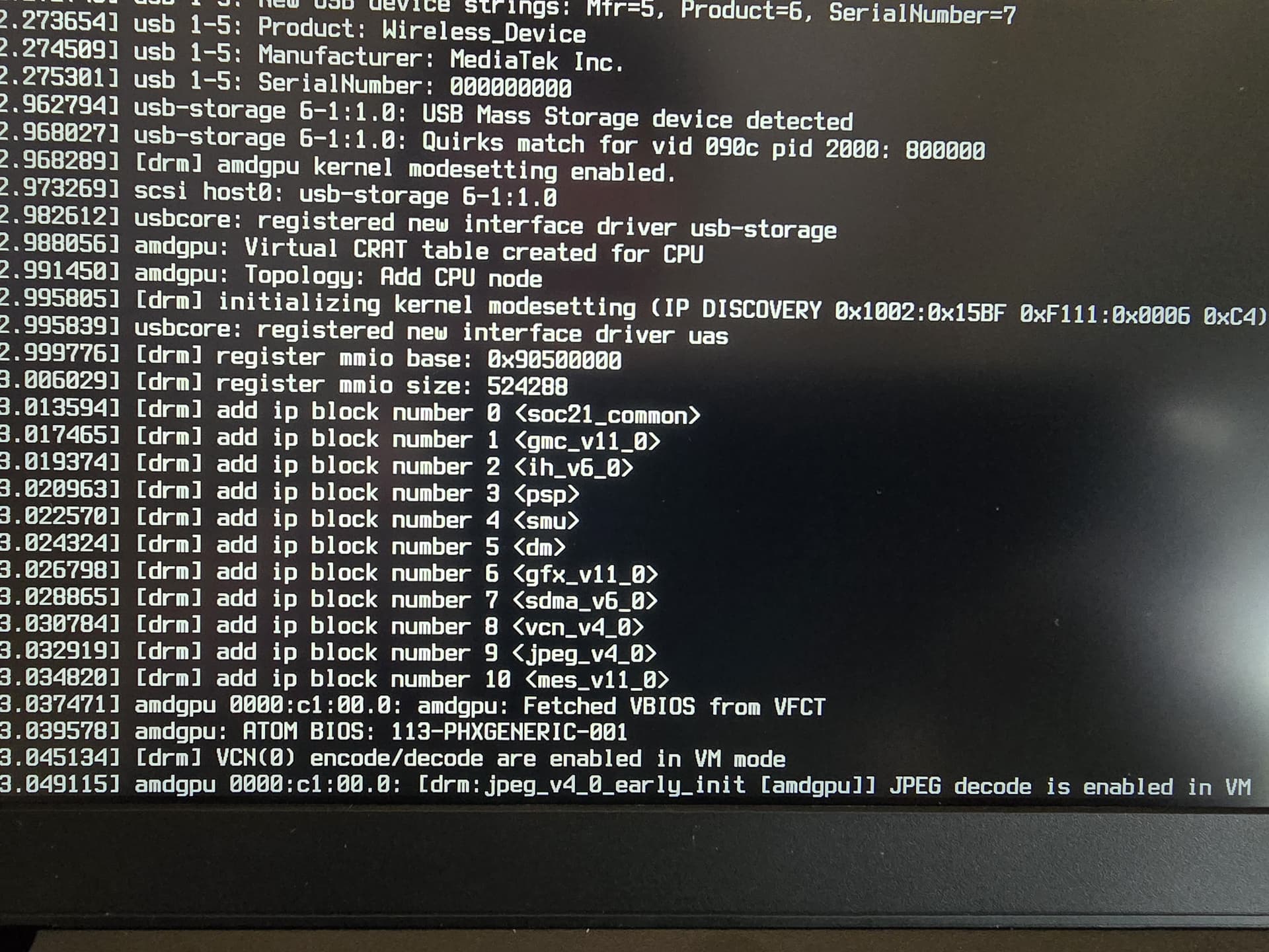

Arch also won’t boot, stuck on “triggering events.” Using an increased verbosity nets the following on Arch:
After a while, I’m getting a code from the LED next to drive captured here:

Okay, some progress. While I waited for bazzite to download before, I looked around in the BIOS and came across the iGPU memory mode (which was set to auto). As I have 64GB of RAM I set this to Gaming Mode.
While Ubuntu downloaded and Arch was stuck on this last line, I remembered changing that setting and reverted back to auto. Ubuntu 24.04 boots up fine (did not check before changing the BIOS setting back to default). Intrigued, I tested bazzite again and received the same error, but was able to continue booting. Installing now.
Will attempt to change that setting back to gaming mode after install to see if I can boot the system. Definitely a bug that should be tracked, though.

I tried Balena Etcher and good old classic dd without success. Issue appears to have been the iGPU mode setting in BIOS
