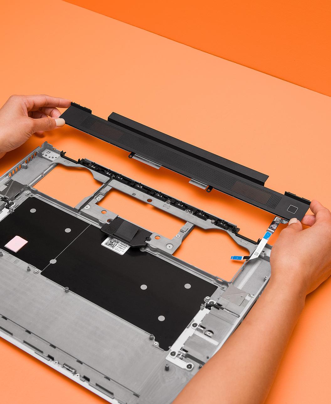

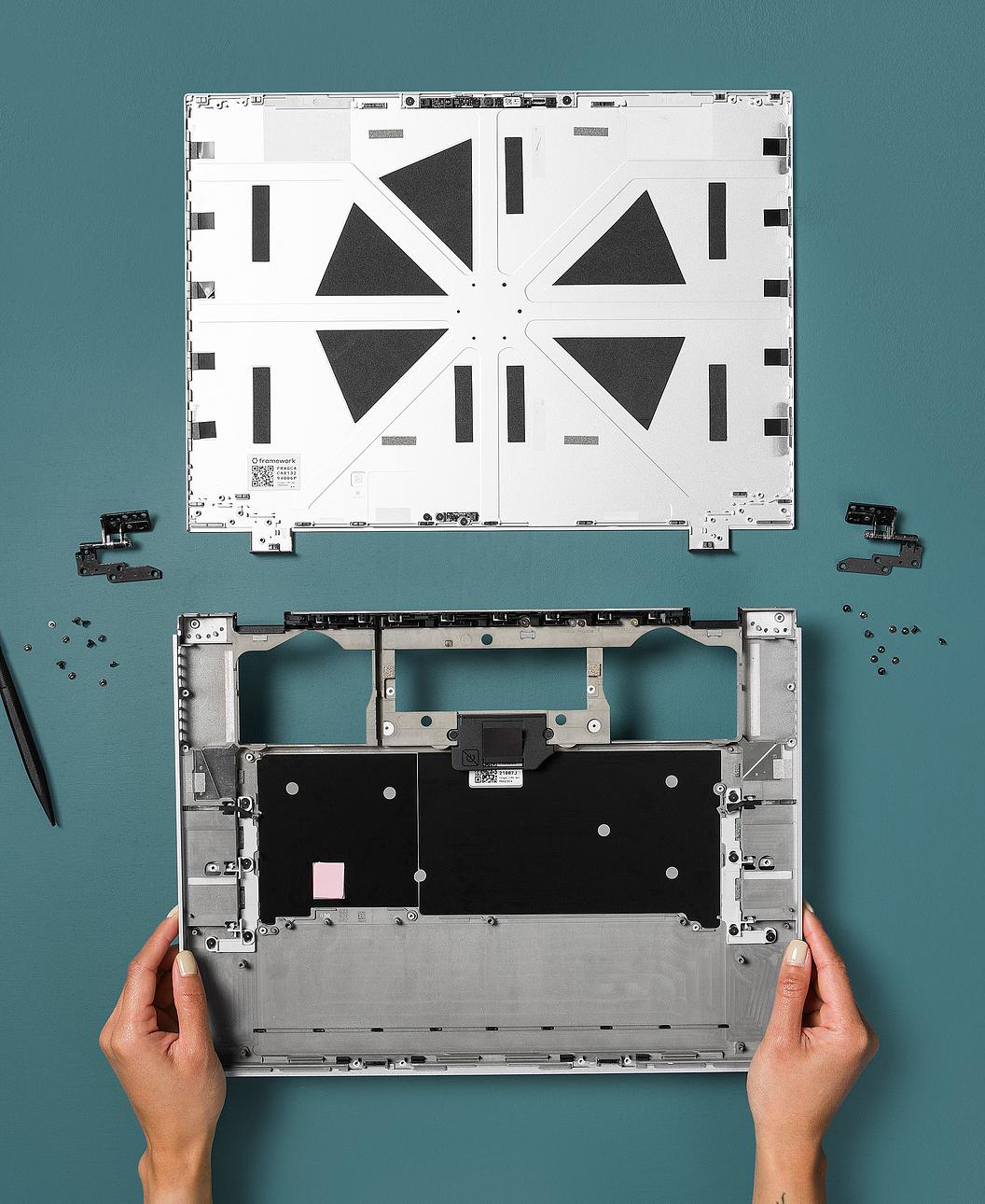

For those of us reading about possibly adding hinge shims without a disassembled FW16 in front of us, the Framework Laptop 16 hinge kit and Framework Laptop 16 bottom cover kit and Framework Laptop 16 ventilation plate pages in the part market place have pictures of the hinges and where they attach.
The picture shows white rectangles, in the corner of the base under the hinge, where the rectangular side of the hinge attaches. The white rectangles are not flat — there are a couple pegs and donut. Maybe they aid alignment, and transfer some forces directly to the base rather than via the screws. These pictures do not show how closely the ventilation plate fits over the hinges.
