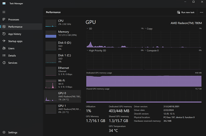

I don’t have anything open that I know of; I’ve hunted down applications through task manager and I can’t find anything. Is there any way to match up background processes to which processor is handling them? That’s the best guess I have for now.
Can you send a screenshot of the applications tab in Task Manager? This way it will be easier to see which applications might be using the dGPU. Also, have you set your performance to efficiency mode in the battery settings?
After I went through device manager and disabled/enabled my dGPU, it seems to be working properly now. I’m only running Brave web browser and VS Code right now; I’m keeping an eye out to see if the the dGPU gets triggered again when I don’t want it to.
