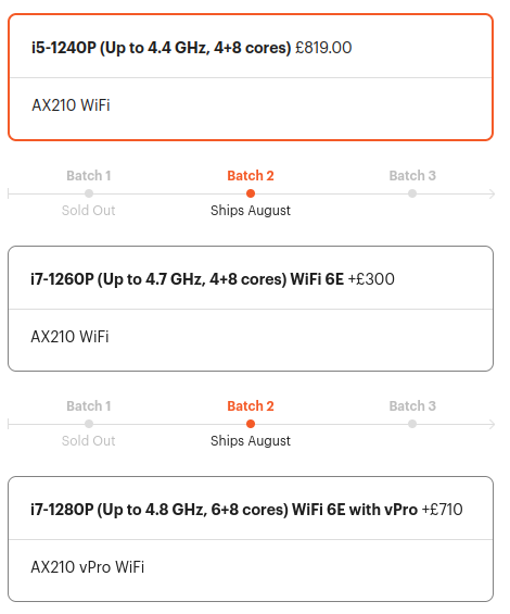

I’ve ordered a DIY i5-1240P and was trying to find an answer to whether it came with WiFi 6E or not as “WiFi 6E” is excluded from the description of the i5 model. As they both have the same AX210 wifi hardware, is there a difference with the antenna that restricts WiFi 6E or is it just a miss in the i5’s description?

Maybe I didn’t describe the problem well. This is what I see on the first page of the DIY configurator. The i7 models both mention WiFi 6E, the i5 does not.
Edit: This is for gb/en
Ahhh, I see what you’re saying. The “AX210 WiFi” line exists, but the “WiFi 6E” text is missing inline with the CPU listing. I’ll escalate this to our e-commerce engineering team for resolution. Thank you!
