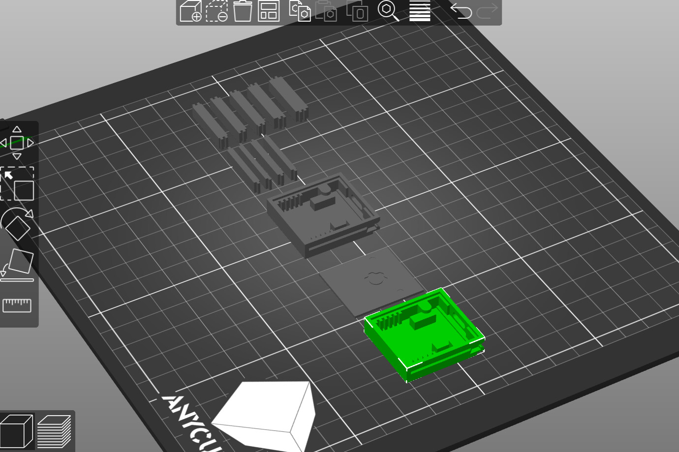

In any case, I just had a couple of questions regarding the adjustable model you posted here:
  • Is it required to take the plastic off the dongle, or only if it doesn’t fit properly otherwise?
  • Based on the context I would assume it’s meant to work with this (amazon.ca equivalent of a USB A-C adapter linked above), is that the case?
  • From what I can tell the cover is just a tension fit/ loose, and stays in because that side faces the bottom of the laptop. Is that correct?
  • In the STL file you provided there seem to be two different bays, but only one cover/set of adjusting bars. Is there any difference between the two?
    • The highlighted one isn’t shown in the preview image you showed above, so I assume it to be the extraneous one.
If you would be so kind that would be quite helpful.
Thanks!
@Graeme_Wiebe
Yes, it is required to take the case off the dongle, most just won’t fit otherwise. It is for a permanent or semi- permanent solution, and, why I made the “true dongle hider” which hides the dongle without having to remove the case.
Yes, that is the adapter, but not the one in your post, it needs to be for usb-c.
The adapter just sits in the bottom, it’s held tight by the side posts and the brace, the usb a to c adapter is off centre, which is why the case is a little deeper than standard, it won’t otherwise fit.
There are two of the same case, it appears. A mistake on my part. One was supposed to have a lid that clicked on to the body. This works well with nylon, I’m not sure about PLA. I’ve uploaded the new file any way, so you can choose.
Sorry, I misread one of your questions. No, the original lid has a couple of small indentations on top, these are to guide drill holes, the indentations line up perfectly with the two posts in the body and are for small screws to anchor the lid. You need to drill the holes yourself, I didn’t include holes because you can choose a screw size that best fit your needs.
