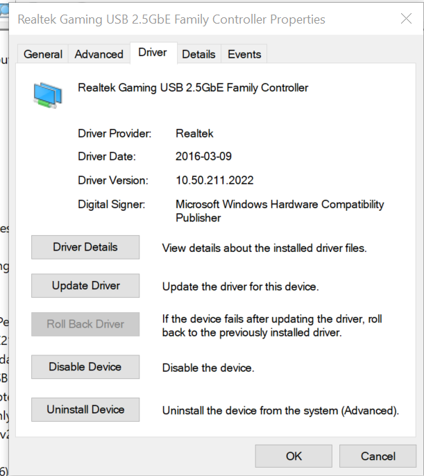

Is there an official driver I should use? Does/will Framework include this driver in their single .exe driver pack?
Windows defaulted to this driver in screenshot; dated from 2016! Does this this right or should I download from Realtek’s driver page?
Would it be possible for someone to explain how to install the Realtek driver?

The driver date is just the original date of the first version of the driver. The driver version windows installs is from this year indicated by the .2022. That is the best driver to use. I updated to the latest driver from Realteck and it killed the NIC performance by 93%

The driver page captured in the youtube video (timestamped below) doesn’t show the RTL8156:
The 8156 driver page should be this:
https://www.realtek.com/en/component/zoo/category/network-interface-controllers-10-100-1000m-gigabit-ethernet-usb-3-0-software
Should be 10.54.20 (screenshot), and not 10.60 (from the video)
I installed the correct version, I think I just grabbed the wrong screencap for the B-Roll. The 10.54.20 version knocked the speed test results from 1400 Mbps to something like 98 Mbps on Win 10.
Yeah, I thought that was a possibility…
Did you try any other previous version(s) between what’s included in Windows 10 and something lower than 10.54.20?
For example, there’s 10.50.20 from Targus:
Drivers & Downloads | DOCK423 | Targus USA
No I just rolled ot back to the Windows installed version as it worked at basically full speed. I’ll take a closer look at the Linux drivers when I get a chance.
