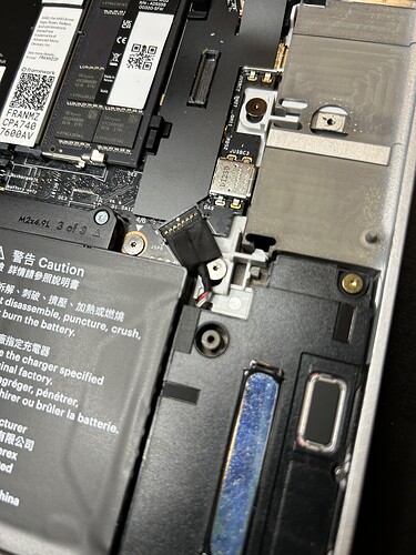

There seems to be some issue with the machine in the lower bottom right quadrant. Any pressure, movement, touch in that area causes the screen to go black and the machine to be completely unresponsive, sometimes even holding the power won’t switch it off, I have to remove the battery. The machine also does this sometimes just being left alone and switched on, so there is something very wrong. Something in this area attached. I have removed and reconnected the pin you see but it made no difference.

Something could be shorting out then and freaking the EC out or the chipset. Probably nothing you did. That connector that is showing at an angle is just the speaker, try leaving it off. I know you are probably at your wits end though with the new machine.
If you want to diagnose it a little further you can set the machine to standalone mode in the BIOS and change the settings for the input module to ignore or something (I am using my phone at work currently to type this) then you can experiment with leaving the battery unplugged and the midplate totally off and see if the same thing happens. You will need an external keyboard connected to USB though. They will likely want your whole machine back so they can have engineering look at what is going on. Sorry bud!

I have removed the mid-plate, battery, keyboard, trackpad and used external keyboard/mouse and it boots up happily but the slightest touch in the bottom right corner, with plastic non-conductive, results in black screen immediately. Same with picking the device up, tilting or any knock or movement. I can apply pressure near the top right or left, or bottom right and it’s fine. Whatever the issue is, it’s with that bottom right quadrant.

Something is making contact and shorting out something else for sure then. Thanks @Destroya for looking into his issue.
Sorry you had a bad luck draw from the get go @Mark_Hall. At least you know it is pressure related in that area; though it is not helping that you can not move it or bump it without the superfreak of the electronics. They have been pretty quick about replacement turnaround if you are still willing to try a replacement DIY model.
