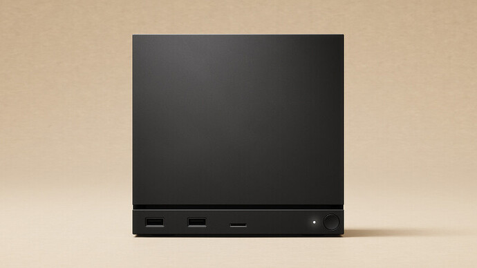

Valve is saying that about their new Steam Machine specifically, which has separate dedicated graphics memory in addition to a single system ram stick. Totally different situation than a laptop with dynamically shared system ram.

It does? I thought that given it was an APU it shared the vram with the CPU.

16GB DDR5 + 8GB GDDR6 VRAM
Up to 4k gaming with FSR 4.1, thanks to a discrete semi-custom AMD desktop class CPU and GPU.
