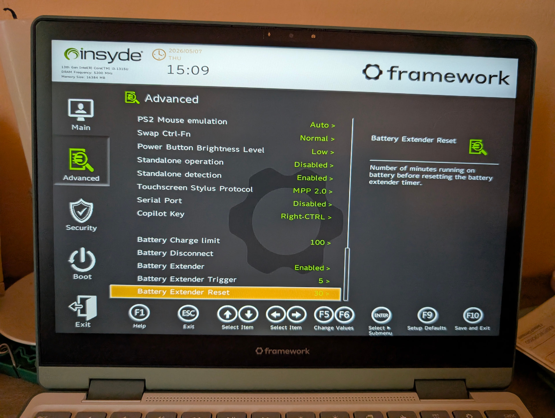

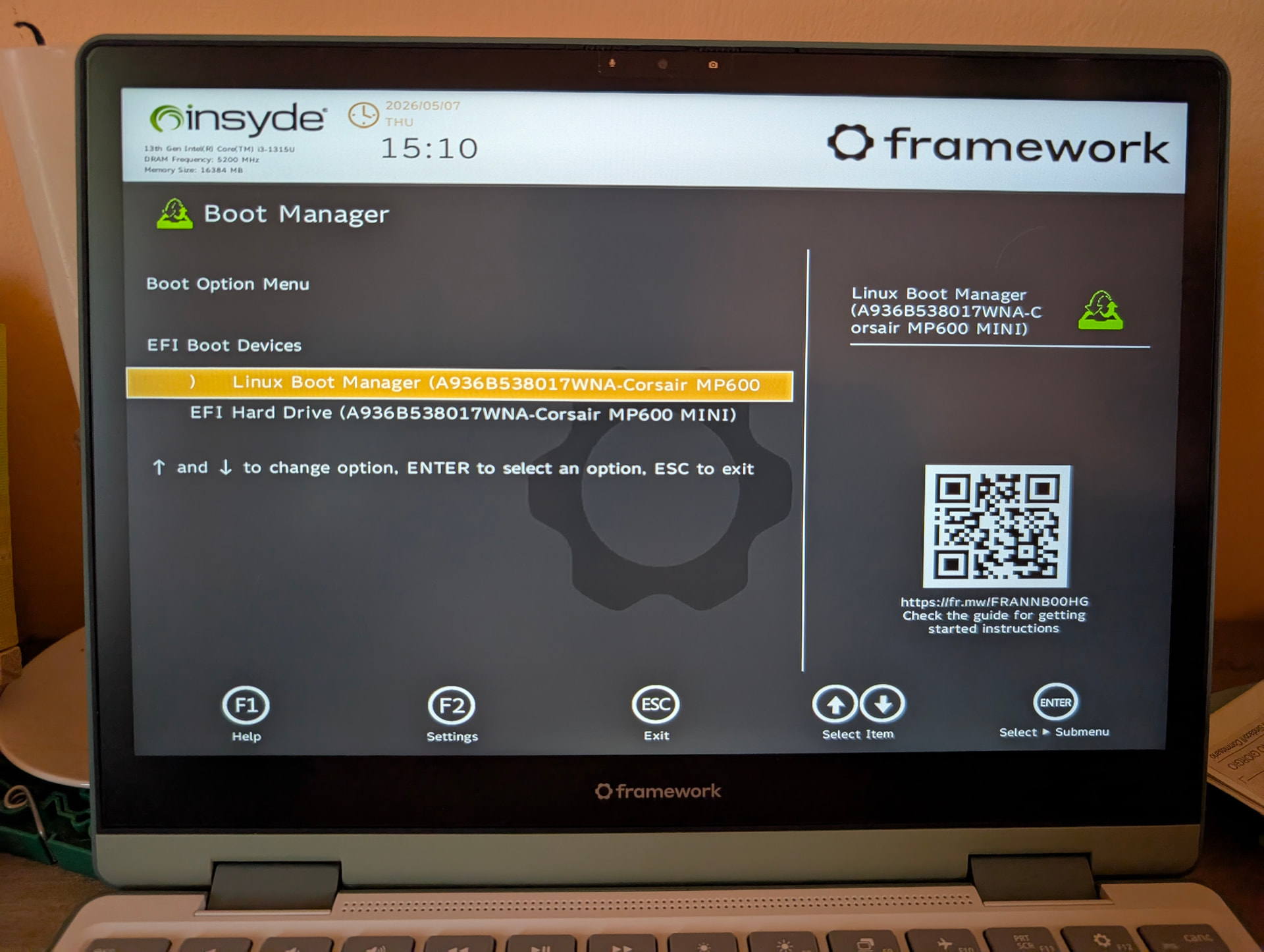

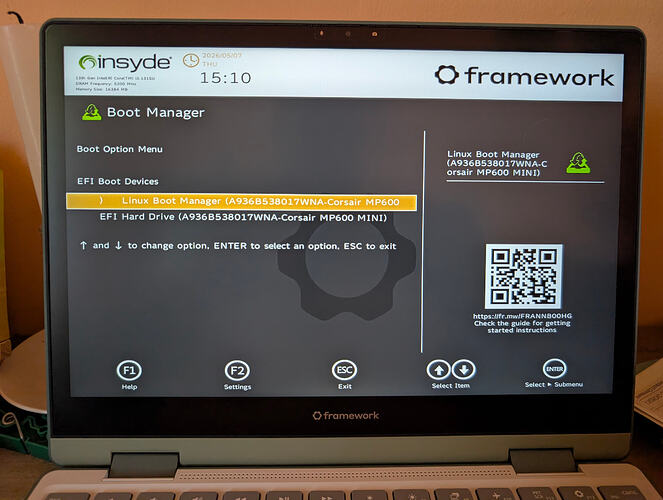

Firmware setup
The firmware setup UI shows:
  • EFI Boot Order:
    1. Linux Boot Manager
    2. EFI Hard Drive
  • Enforce Secure Boot: enabled
  • New Boot Device Priority: Auto
  • Automatic Failover: tested both enabled and disabled
  • USB Boot: normally disabled
I attached screenshots of the firmware setup pages showing these settings.
