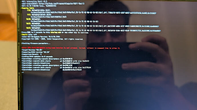

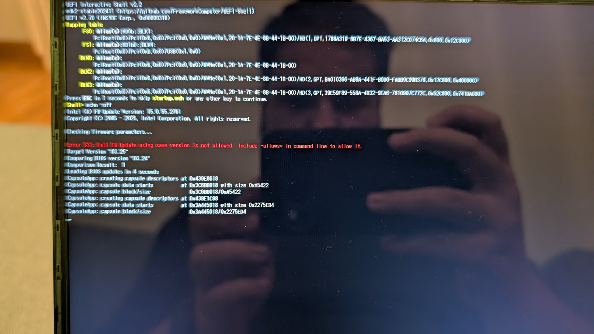

Hi everyone! I’m having some problems with the BIOS update in Linux, using the UEFI Shell.
As following the steps for booting it from the USB Flash Drive, the UEFI Shell comes with the following log before restarting the computer:
For checking the BIOS was updated after the reebot, I follow the guide and use the commands that Framework recommended. As you can see, the version that outputs is the previous one:
It’s mostly probable that I missed something. Thank you in advance for the help!
Same error on previous upgrade here Update BIOS Failed
The OP and another user fixed it by formatting the USB stick again (GPT+FAT32). You could also try a USB 2.0 drive.
I was able to update via the EFI method with no problems. Best of luck.
The problem still continued after formatting again the flashdrive as (GPT+FAT32). I got inside of the startup.nsh file, where I could edit it and add the option that was asking for in line 11. The error didn’t appear and it seemed like it was applying the update.
UPDATE: I found the problem. Apart from what I said before (adding the option in startup.nsh in line 11), I also needed to plug in the laptop. It seems that the update also checks if the laptop is on battery or plugged in. Now the BIOS is totally updated.
Thank you all!
