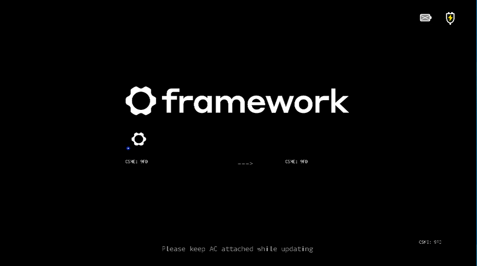

Instructions for Windows Installer:
  1. Run the .exe.
  2. Click yes to reboot.
  3. Wait for the firmware progress bar to complete, and then the system will reboot.
  4. If you are updating a system in standalone mode, please pay careful attention to the standalone update process below.

  4. Let startup.nsh run automatically.
  5. Follow the instructions to install the update.
If doing a standalone update, the display output will not work during the retimer update. Please note that retimer updates take 2 minutes to complete. So please wait at least 5 minutes before attempting to power off or reset the device.
