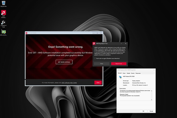

Switching the GPU BIOS setting from āAutoā to āGamingā resolved the black screen issue on newer AMD drivers for me. Hopefully a fix will come around and I can switch it back, but the memory impact is minimal and I donāt need to worry about Windows Update pushing me back to a broken state.
