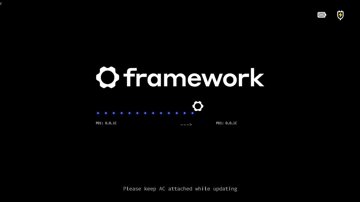

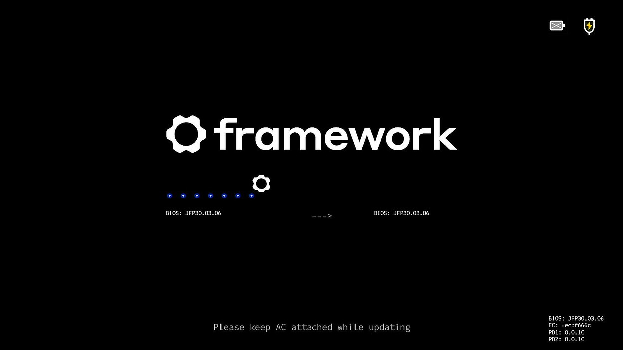

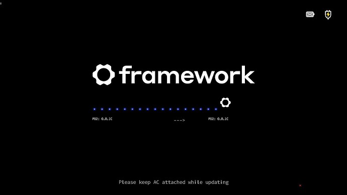

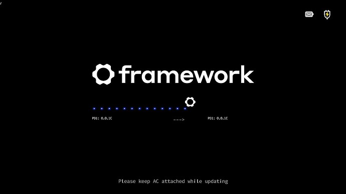

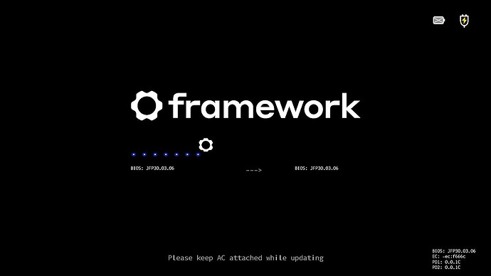

Updating a Mainboard outside of a laptop
This release supports standalone updates without a battery attached. After rebooting, please follow the onscreen instructions to update your BIOS when in standalone mode, which will require moving the power source between both sides of the Mainboard to allow PD firmware to update correctly.
Please note that the power and display output must be connected to the same side during standalone updates. Failure to do this may result in no display output during the update process.
We recommend the following update flow for standalone updates:
Part 1
Ensure that standalone operation is enabled in the bios advanced setup menu.
Display connected to upper left port.
Power connected to the lower left port.
Run the updater from EFI/Windows updater.
After rebooting into the updater the update will commence:
The updater will update the BIOS and EC.
The Updater will update the PD controller that is not connected to the power source.

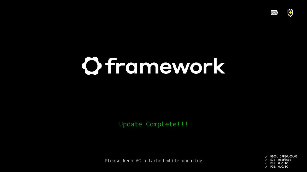

You will see one PD controller will fail the update with the X, and “update complete” is displayed, but the bios will restart.
Part 2
At this screen, the bios update will stop. You must disconnect the display and power source, and move them to the other side.
The display should be connected to the top right.
Power should be connected to the bottom right.
Press the power button, and the second PD update will complete.
After this, the system will reboot, and your bios update is complete.
