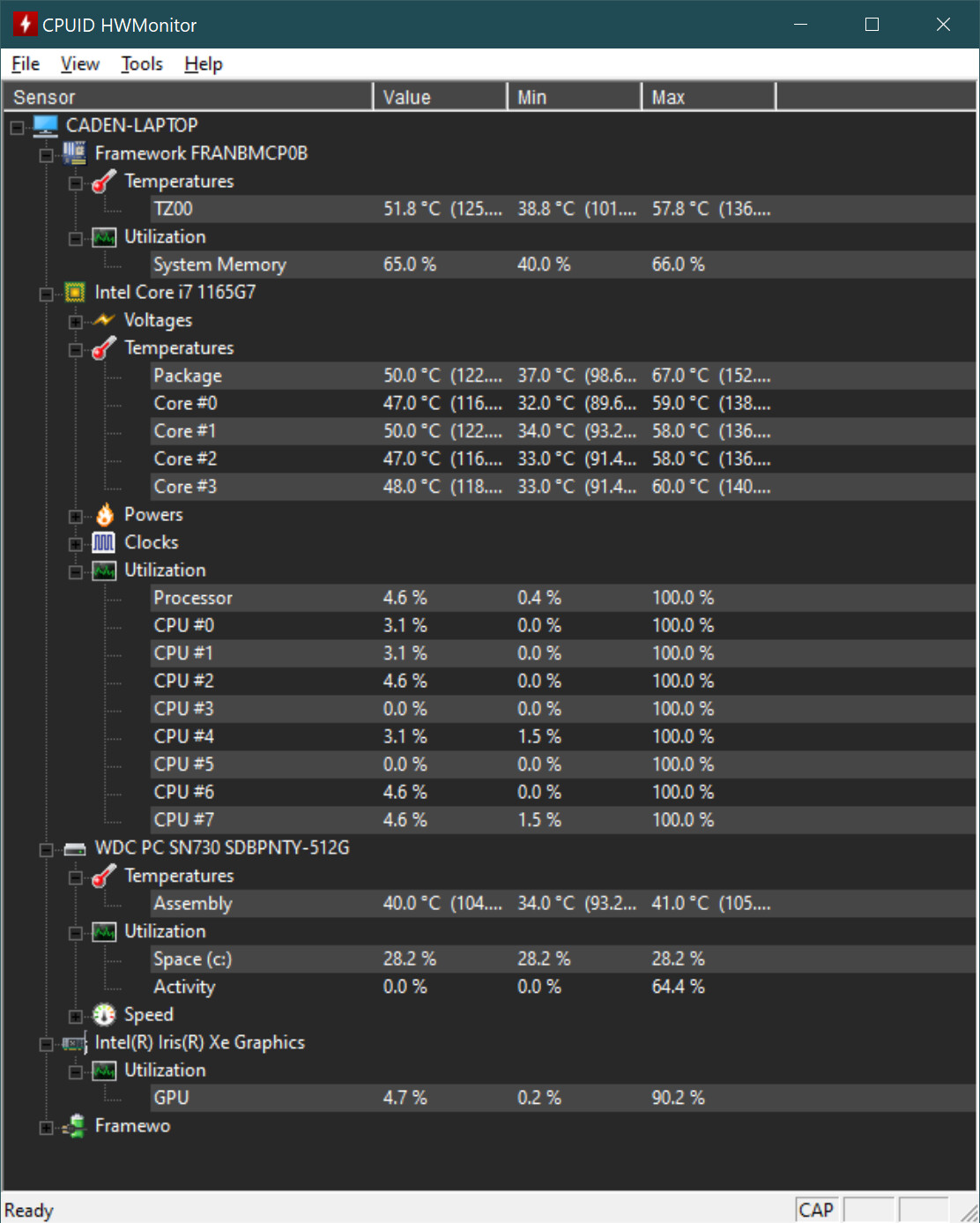

I tried to update the drivers, but it said they were already up to date. Also, I checked the temps and they were around 40 - 50 c. Not really all that bad. I can’t really think of anything else that could be going on though.

Again, make sure your RAM is not reaching, say, 75% Or 60%.
Because again, as I said earlier, there is no dedicated video memory for integrated graphics, and therefore you need to make sure you have enough RAM leftover.
I have a similar issue with running GTA V on an 8GB system. The RAM will hit 80% or 90% and then either the game or Windows will crash (depend on whether graphics or the process is trying to allocate memory that is currently in use). I am able to do the first mission (the bank one), but the second one involves driving around (and perhaps map loading) I could not get to the end because things keep crashing
Max RAM usage was 65%, which might be the problem? 65% doesn’t seem that high to me.
