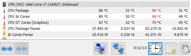

OMG, this PTM7950 is amazing! (Arrived after about 2 weeks…well worth the wait)
I’m able to boost to 63.275W, from idle of 34c (warm day). AND it stayed above 60W for a good 2.5-3 4.0 to 4.5 seconds. (Polling ever 500ms, and able to get 9 rows of results higher than 60W)
Think this is the end game TIM for the Framework Laptop…without going into liquid metal territory. I’m truly amazed.
@Second_Coming wow that’s impressive performance and I’m glad someone else with a Framework is able to confirm it working well!

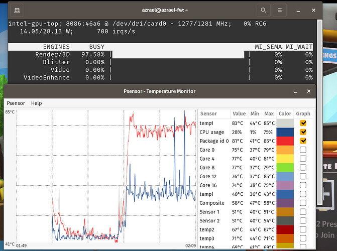

Here are 2 of the charts I did last night, I noticed the temperatures are both high due to the iGPU running hard, something that is present when I was using a laptop with an i7-3667U and an i5-5257U.
This was in Overcooked 2 single player, title screen. The overheating occurrence I had was when I had all cores enabled playing multiplayer and hosting the game. I notice lower temperatures when I disabled 7 of the e cores and but still observed game lock ups. I decided to not host the game with 7 e cores disabled did the game become playable. The ambient room temperature was definitely higher then too.
Notice that my CPU usage wasn’t high, so I guess the game hosting probably increased CPU usage too.
From what I see, I don’t see any indication that your system is actually overheating/thermal throttling (at least the CPU, not GPU). I’m going to try to not get too much into troubleshooting territory as that’s not the topic of this thread. That being said:
It doesn’t look like any of your CPU cores (even with all cores enabled) go above 85C – those temps are well under the 100C max. What’s your CPU frequency at 85C?
To determine if your system is actually thermal throttling, you can stress the CPU/GPU to see if it maintains the proper frequency at the given temperature. s-tui’s stress test is a simple way to check the CPU.
With the information provided, I think that your system might not actually be overheating and the wifi disconnecting is a separate issue.
But zooming out of troubleshooting – thanks for the graphs, and now there’s a “before” to compare with PTM7950!
