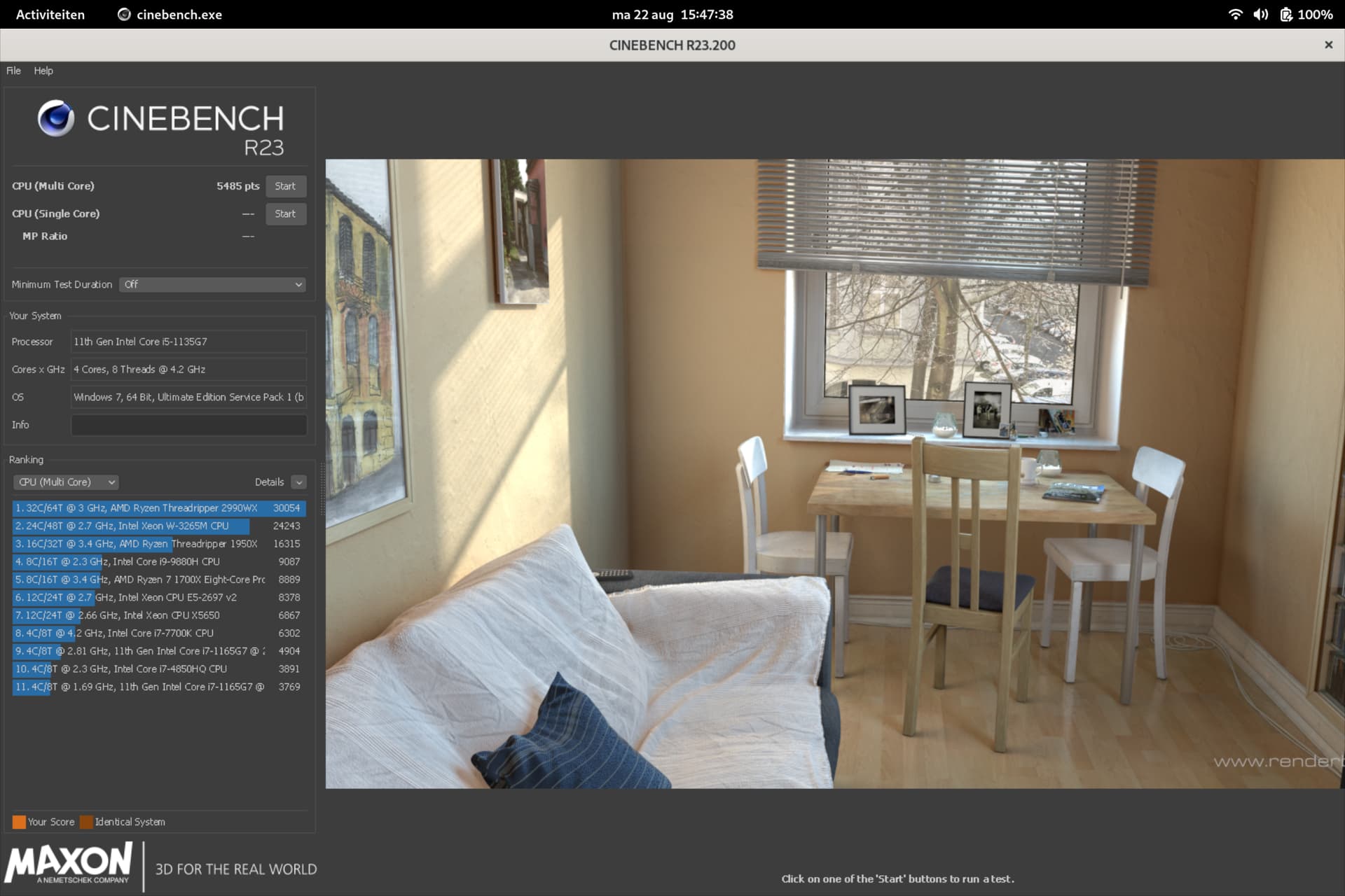

I got 5485 on my i5-1135g7 just now:
(yes this is on Linux. Cinebench runs perfectly fine in wine)
Odd that it didn’t update the “Ranking” bar chart.
It tried to, but I didn’t gave it write access to create a subfolder in wines “My Documents” equivalent.
