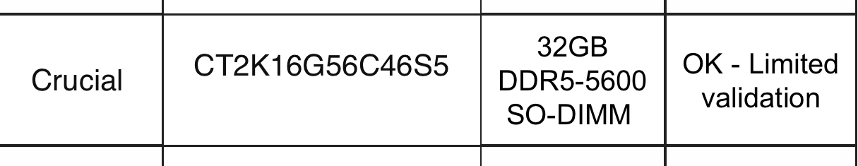

From Framework’s list:
What I bought:
There is: What DRAM/memory is supported by Framework Laptop 16?.
It includes the RAM I bought.
