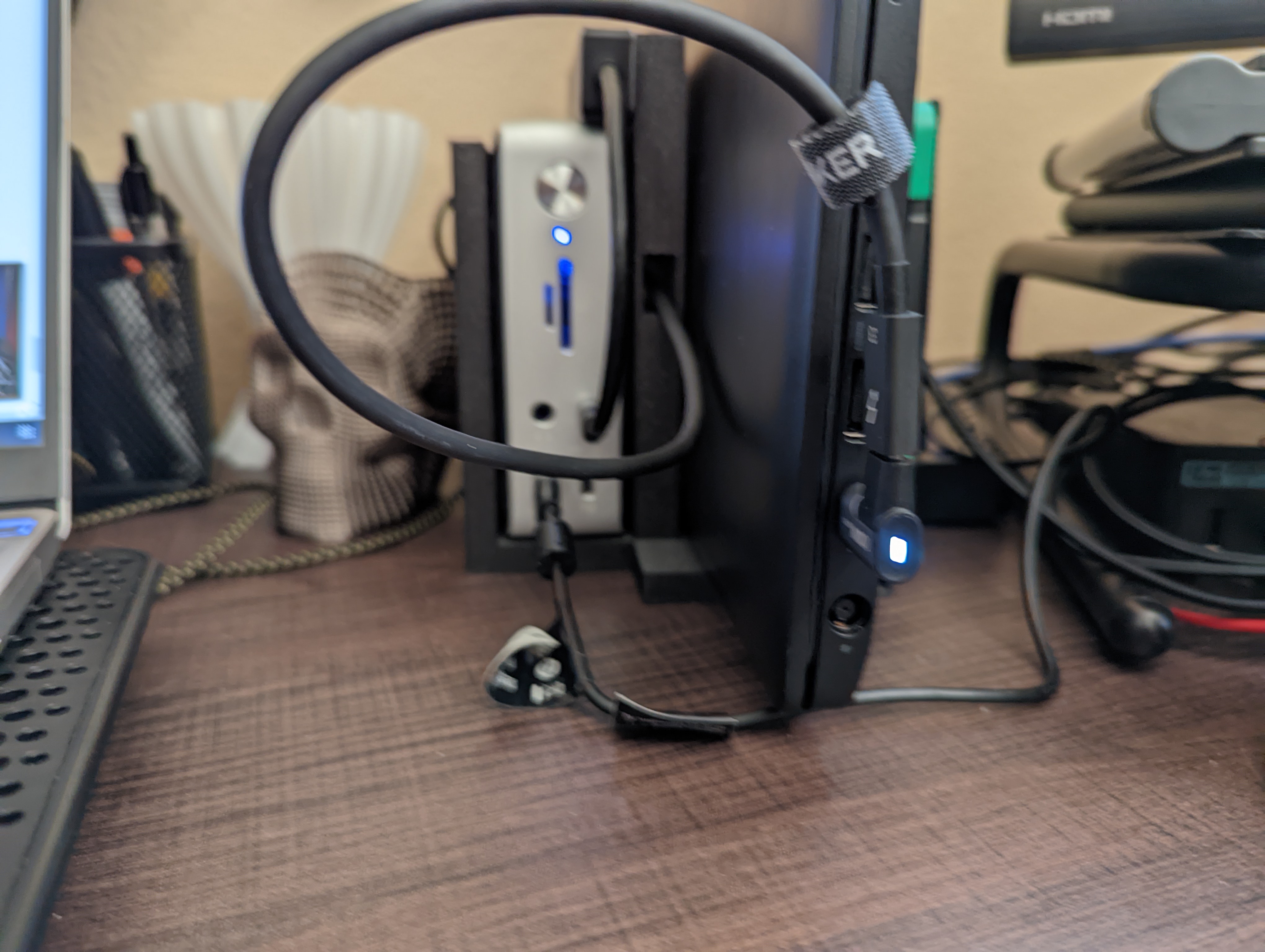

The right angle is actually a problem for me. Picture for reference, my work laptop:
Combined with the cable’s end, it’s too tall and won’t point down, so now it’s actually blocking ports, the exact opposite of their advertise “feature” of being right angled and smaller than similar products. I prefer not to plug my web cam into the dock (my work laptop gets weird with it unless plugged directly in), so that’s a problem.
Unrelated, the magnet is weak. Good for the original magsafe idea of “can’t rip the laptop off the desk by accident!” but terrible if you lightly brush against it.
All that said, they do work as expected. Both monitors, ethernet, USB, etc. all function as they should and I get the full charge rate. I mostly picked them up to make switching from my home to work laptop during the work week a bit easier, and it arguably does that. If I didn’t need to use my work laptop at home the only real complaint would be how weak the magnet is, as I could lift my 3D printed dock/laptop stand and/or design a new one to incorporate the adapter better. However, for the foreseeable, I find it hard to recommend.
