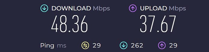

So I have not had a chance do to the live usb test you mentioned but I did change my router to only use wifi 5 and then run the speedtest on my desktop (cable not wifi), the framework and my phone (Honor Play).
The framework was really, really bad!!
Attached are the speeds and you can see what I mean.

I just found out it is an issue with the signal strength from my router.
I tested the speeds in my lounge room and then went to the room where the router is and ran the test right next to the router and the download speed went from 48Mbps in the lounge room to 842Mbps next to the router.
