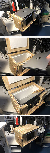

My method to solve the HOT and LOUD fan issue
Dang the fan is loud!
And the laptop gets hot! Especially when you run your fingers around the bottom.
This is my solution thus far. I built a plywood acoustic box.
I insert the laptop at an angle and then have 2 PC fans constantly blowing air out.
It works but i dunno. Anyone else deal with this issue?
The laptop cools better when the screen lid is open. Are you always running it closed (inside the box)?
probably. but it’s so loud when the lid open that i can’t hear myself think.
ya it’s always in the box now. I have a “Plugable 16-in-1 Thunderbolt 4 Dock” hooked to it (external monitors etc)
