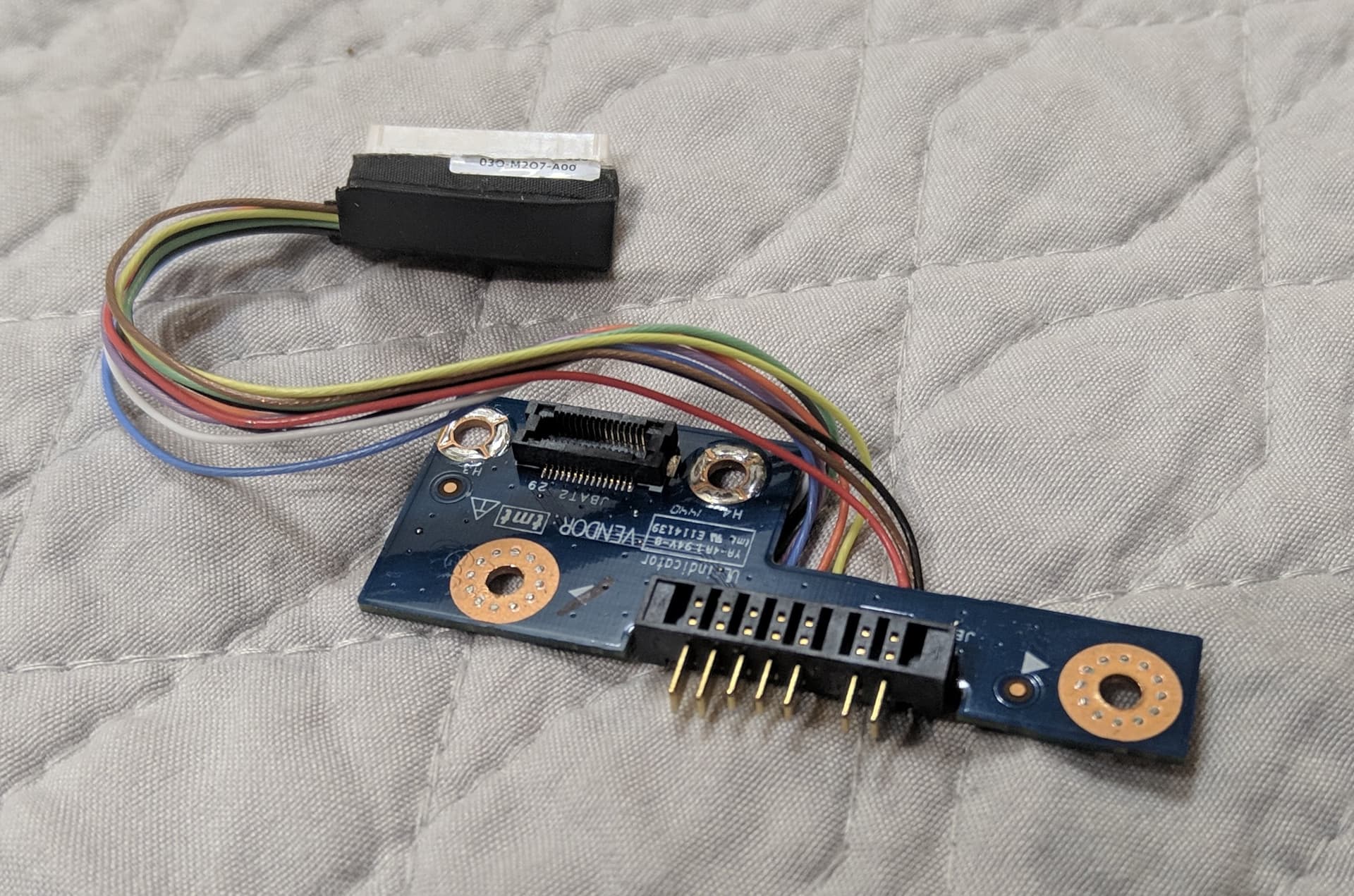

I figured out that the dell latitude 3310 battery connector cable (part number VJMM0) has the same ACES connector as the oem battery but is on a much longer cable and is only arround $10
did you make your cable? the ACES connector from dell cable but about the motherboard side. where did you get one?
@Ivars_Pepsons My life unfortunately gets completely overtaken by work for large chunks of the year, but to answer your question, the one cable I made used a similar connector to the OEM connector on the mobo side and a connector I desoldered from an old Thinkpad motherboard for the battery side. Very janky but it works. I’ll probably order some of those Dell cables, though–thank you @djangorb–along with some appropriate parts for the battery end from aliexpress.
I did build the cable and it works perfectly. I got the dell cable from ebay and for the battery connector I bought a Lenovo LS-B093P battery connector board, also from ebay. I then just cut off the plastic pin and soldered the wires from the dell cable to under side of the Lenovo PCB, no de-soldering required
Cool. Pic?
i don’t have a picture on hand but i will take one in the next few days
Here is the cable I made. Sorry it took so long to take the images
Looks like several laptops use connectors that may be compatible. A few even come on cables. HP ProBook 450 g2, g3, Acer aspire. But it looks like the Acer Aspire is the only one out of those that don’t leave one pin unconnected.
ebay search
Thank you very much!
looks like the 0NMPKX is even longer cable. thanks mate for the heads up!
