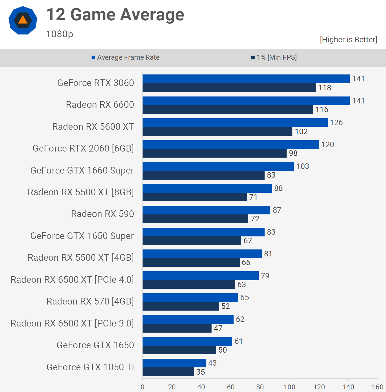

Theoretically that’s true. Let me share some very useful graphs, courtesy of TechPowerUp and TechSpot/HardwareUnboxed
This first graph is PCIe scaling behavior of a 3080, note that x16 gen 1 (same bandwidth as x4 gen 3) is around 87% of expected performance at 1080p, and 90% of expected performance at 4K. The performance penalty decreases as resolution increases.
This is average performance for the 6500XT, we can see that the performance penalty of going from gen 4 to gen 3 is roughly 25%-30% on average. The drop in bandwidth hurts the 6500xt far more than it hurts the 3080 and the penalty can be mitigated by increasing resolution for higher-tier cards. Don’t ask me why.
Granted neither of these graphs account for TB overhead but I don’t expect that should change the overall conclusion.
