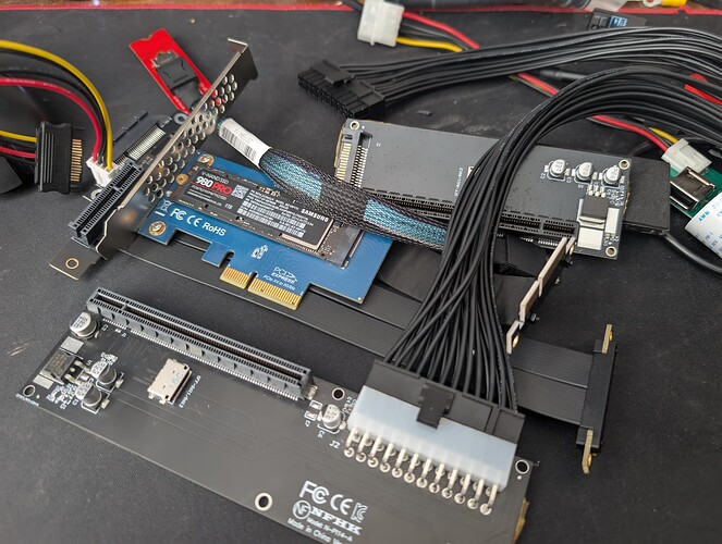

This has been very close to my experience so far. Haven’t had any gfx11 cards work reliably at all. I’ve done some pretty hacky stuff previously and I’d like to think I’m familiar with all of the pcie limitations but I’ve got a giant collection of cables I’ve used to get things working and have not had very good success. Ive used some of these cables very reliably in an emulated steamdeck on my homeserver so I think the issue lies strickly with the FW Desktop.

The path to oculink with 4 x 4.0 is rocky and full of adapters and cables incapable of handling 64g/s…
I know this setup i’m using is working in practice. I’m pretty sure this purely is a software issue…

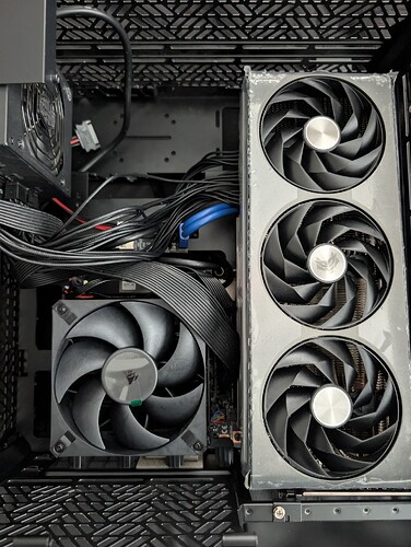

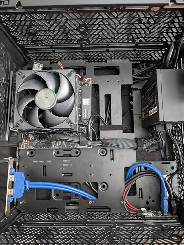

Yeah so AMD gpu’s on the desktop straight up do not work. I’ve tested a 7900 xtx, a 7900xt, a 7800xt.

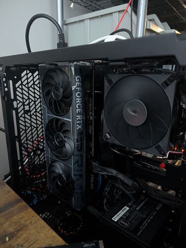

I picked up a 5080 at Microcenter an hour or so ago and used my modified riser cable and other than it just disabling video on the igpu at boot, it works great. Inference works on both gpus.
Nvidia 5080 running
Case Setup
Cables tested

Usage with the Nvidia GPU seems to work good. Inference on both the iGPU and GPU mean I cant really complain there. I occasionally have an issue where display goes black but I think this is due to some power issue where the motherboard cannot supply enough power, the card will reset and then take the rest of the system with it. I continue to have audio after this blackout but at some point, the system will stop responding and I need to reboot.
