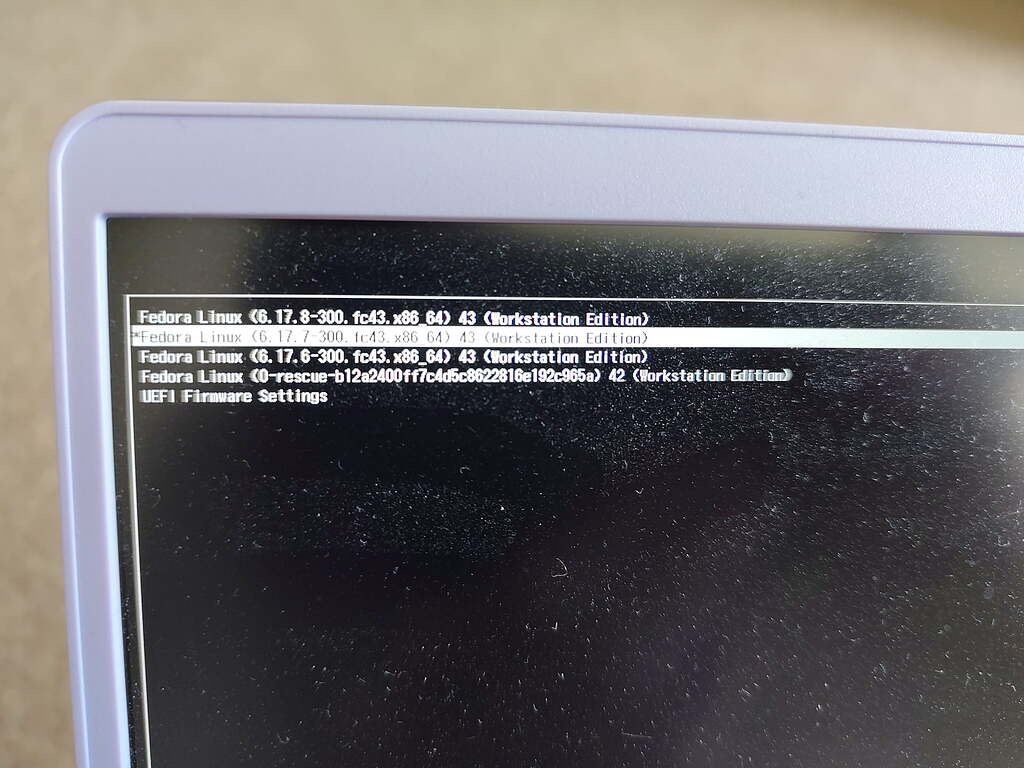

  5. After the next reboot, I was having issues with entering the LUKS key because I thought the machine was frozen, but it turns out that just the screen was frozen and I could still enter input and press enter and it would continue
  6. I also tried using an external USB keyboard, same result.
I think maybe something I did messed with the LUKS screen since I don’t get that visual feedback anymore. I also can’t even hit Esc to switch back to the systemd bootup log. Nothing happens.
Ideas?
Yep I have the same issue here, Seems related to the 6.17.8-300.fc43.x86_64 update from yesterday. I can rollback to the previous kernel since I use Fedora Silverblue and that fixes the typing not showing up on the LUKS screen.

I dodged this issue by loading kernel 6.17.7-300.fc43.x86_64
I’m staying with that one until I have certainty the issue has been resolved.
