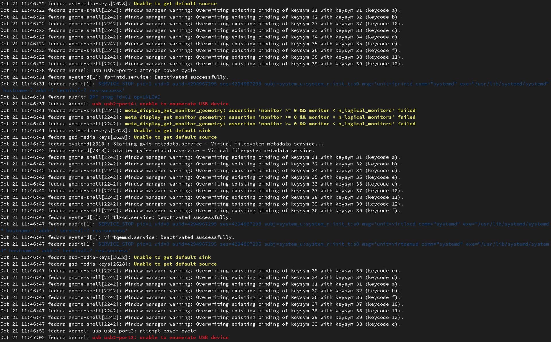

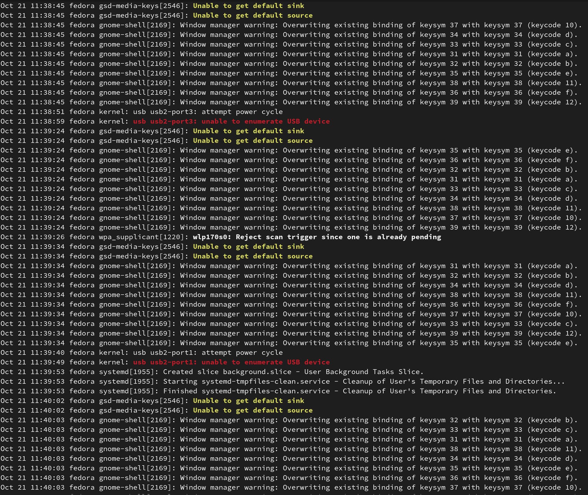

- Plugging the HDMI cable in/out of all 4 ports with
journalctl -frunning, which looks like this:
