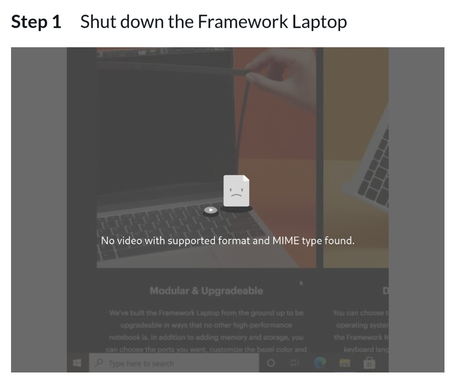

I am getting an error when trying to view many videos in Firefox other than on YouTube on my AMD laptop. Here is an example on the Framework website:

On further investigation, I’m able to play video in Chrome without installation of any other software, so this must be a problem related to Firefox’s default setup under Fedora.
I think fedora by default uses a flatpak firefox that does not connect to ffmpeg for whatever reason.

I tried both of these and the behaviour didn’t change. I will continue to use other browsers as a workaround and monitor this thread if anyone else is able to document a solution.
