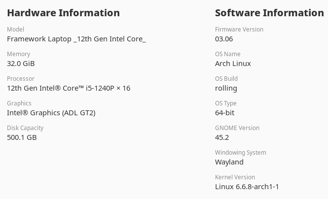

I’ve recently done a fresh install of Arch Linux on my Framework 12th gen with GNOME as my desktop environment. To my surprise, both the ambient light sensor and the brightness keys work simultaneously without adding module_blacklist=hid_sensor_hub to my kernel parameters! Also, without applying any battery life optimizations (other than installing power-profiles-daemon and setting the power plan to power-saver), my device uses ~1% of battery life per hour during suspend (s2idle)!

I’m assuming on linux kernel 6.6.8?
Whoops, I forgot to say the kernel version! Here’s all the important hardware and software info from GNOME’s system details menu:
