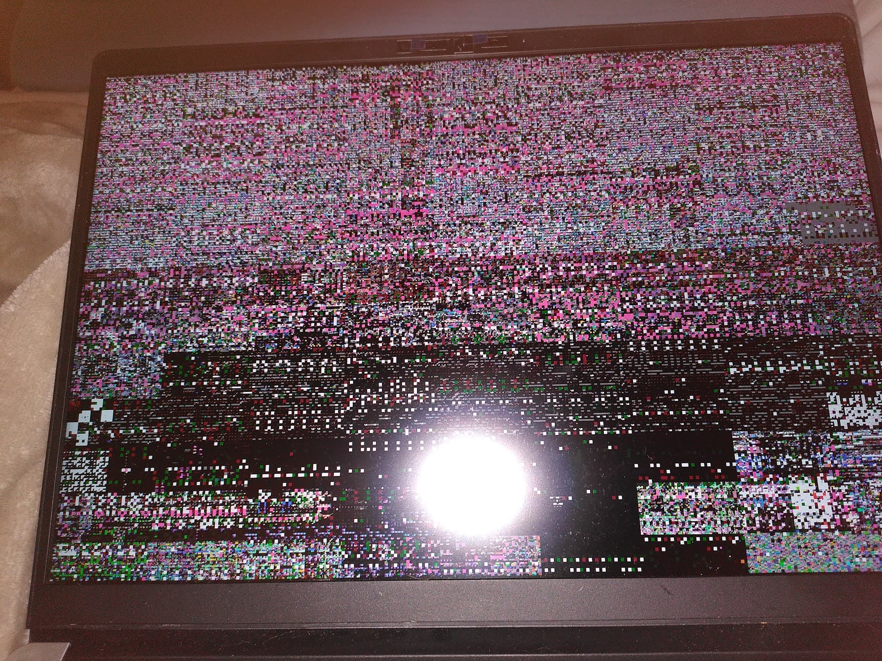

Hello,
I will on an almost daily basis get this sort of noise on the display of my laptop:
It almost always happens after the laptop has been idle for a while - e.g. I go get a cup of tea and come back to this.
Interestingly, if I press a key on the keyboard, the noise will go away while the key is being pressed, but will return once my finger leaves the key.
My machine: Batch 11 of Framework Laptop 13 (AMD Ryzen™ 7040 Series)
Order placed 30 Nov 2023 - the invoice does not indicate which generation it is so I am hoping that is sufficient to figure out the generation
OS: Fedora Linux, 6.7.5-200.fc39.x86_64
Edit to add: I will from time to time encounter laggy and frozen behaviour when playing video games or in video calls, and I do not know if this is related or a separate issue.
Let me know what more information I should provide.
Thanks! #linux
There are a few known bugs with the linux kernel drivers for this GPU. I’d set the iGPU config to UMA_GAME_OPTIMIZED in the BIOS, see if things improve, and if not, add amdgpu.sg_display=0 as a kernel parameter. You might also have better luck with Linux 6.6.
Welcome to the community @ElizabethP
I’d start here:
If that’s no good, then test against a Live USB of Fedora, see if this is replicating in a live environment.
Hi! I changed the BIOS setting to UMA_GAME_OPTIMIZED and it was going alright until tonight. I was idle for a while and then I started trying to enter password when coming back the display noise came back.
I was able to log in by touch typing, do alt f2, and enter r to restart the shell – I’m on X – and that made the noise go away.
Here is the tail of dmesg after this experience. Scroll to about halfway for where the system hibernates (around 117280.290245), then not long after amdgpu error messages start cropping up.
