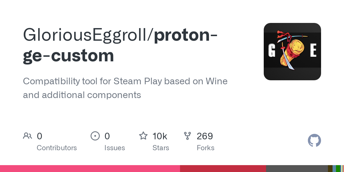

Additionally, there are community forks of proton that are not officially supported by Valve, one of the popular ones is “Proton GE” or “Glorious Eggroll” edition. The GE versions of proton have some extra fixes implemented for specific games to get them running, and they enable some in-game cutscenes and videos to play that would otherwise not play. This is due to licensing reasons with the WMV (Windows Media Video, proprietary to Microsoft) format that Valve can’t officially support but the GE version is able to. Valve plans to have server-side transcoding to get around this but it’s not ready yet. I would use this as a last resort if you can’t get the game to run through Proton Experimental or an older version. It’s not too complicated to install, but you would need to go to the github site and follow the installation instructions
