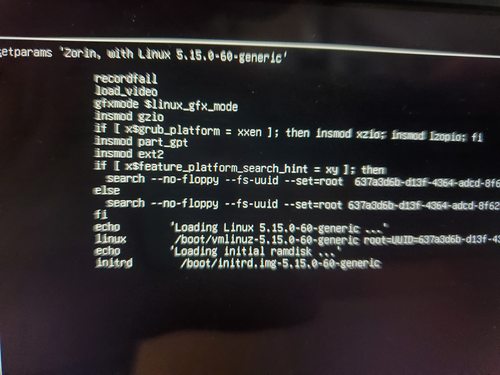

Did you run this in a running Xorg/wayland session? Did you (accidentally) configure nomodeset on your kernel boot parameters?
I don’t know what Wayland or nomodeset are, so it’s unlikely I’m using them. Following advice on the internet:
“echo $XDG_SESSION_TYPE” outputs:
x11
I’m not quite sure how to check for nomodeset. Going into the GRUB boot menu by holding esc on startup, I see this:
Posting the link from the duplicate thread here:
