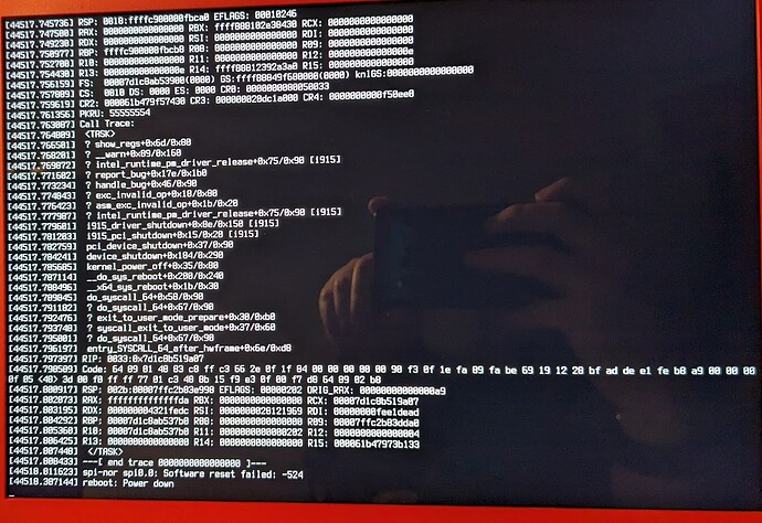

This is what I was able to capture of it before:
The display driver is featured in that stack trace, so yeah it’s starting to look like the HDMI expansion card might have something to do with this. I assume this problem goes away if the card is not installed?
