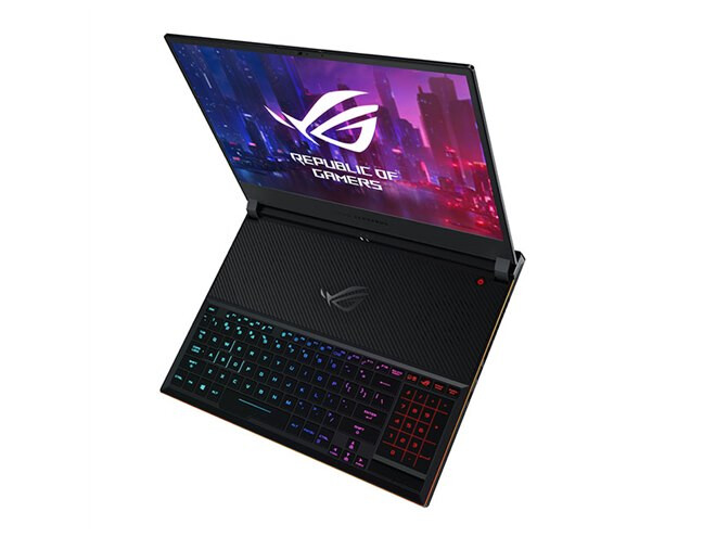

The idea is simple: position the keyboard closer to the user, where the trackpad usually sits. Subsequently, move the trackpad either to the right-side of the keyboard or forward, where the keyboard would usually be.
This is nothing new, rather, the goal would be to replicate the design seen in the Zephyrus series from ASUS/ROG:

As for why someone would want their keyboard like that…let’s say that I dislike having my wrists placed at the same level as the keyboard, I rigorously prefer them to be 1cm or so lower, therefore the only option is have the keyboard high up on the laptop and lay my wrists on whatever the laptop is sitting on :slight_smile: ! Then, to limit hands movement, the trackpad would ideally be on the right, turned 90deg (hence taller than wider), a bit unconformable, but can work with a high enough sensitivity. That said, the benefit of not lifting hands (or using thumbs) to use the trackpad are not to be underestimated, plus, “mouse on the right-hand side of the keyboard” is much closer to a desktop machine.
