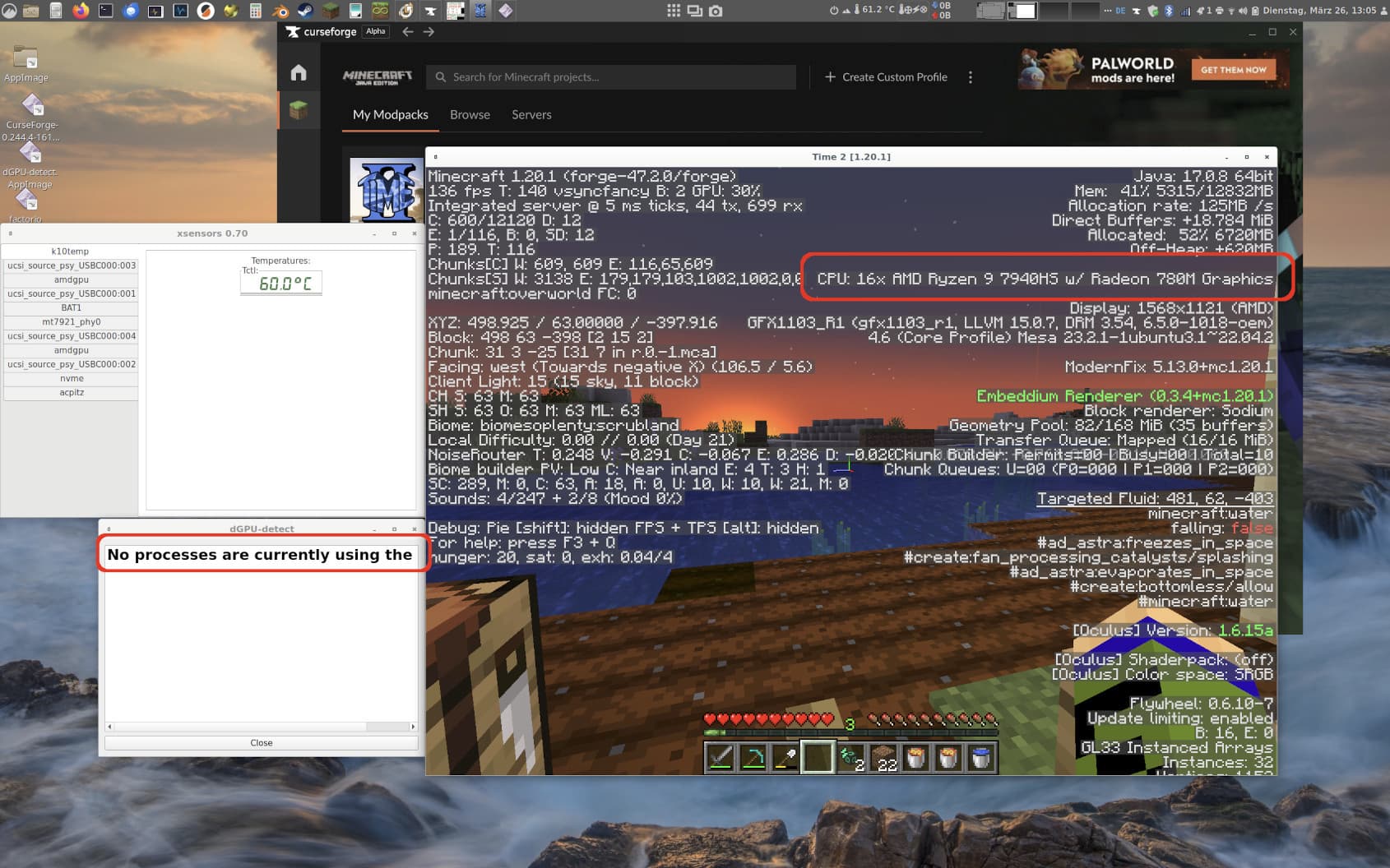

[SOLVED] dGPU is not used with java on Linux in my case Minecraft or more precisely the CurseForge Launcher
Edit:
The solution is in third post
Hi,
I’m a bit annoyed by the topic.

I’ve tried the following so far:
  1. Start the CurseForge launch using
    "DRI_PRIME=1 "
    “DRI_PRIME=1!” # why is that! at the end? I read this in the forum in connection with steam here and also tried it out. On Steam, the version with an exclamation mark works for me.
  2. Start java using a script in the Minecraft Launcher options
    The script is from here.
    I tried both variants.
#!/bin/sh
DRI_PRIME=1 exec /usr/bin/java "$@"
and
#!/bin/sh
export DRI_PRIME=1
exec java "$@"

When I inserted the script here as described on the website, I always got the same error when I tried to start Minecraft. I tried it with and without hooks.
The error message:
Here I tried to insert the line “DRI_PRIME=1 %command%” in all variations into the line, which had no effect.
No matter what I tried, it was always unsuccessful, even starting the entire launcher via the console, which showed that Java was supposedly using the dGPU, the iGPU remained active and the CPU briefly heated up to 100 ° C and then went to 70 -80 °C down.
