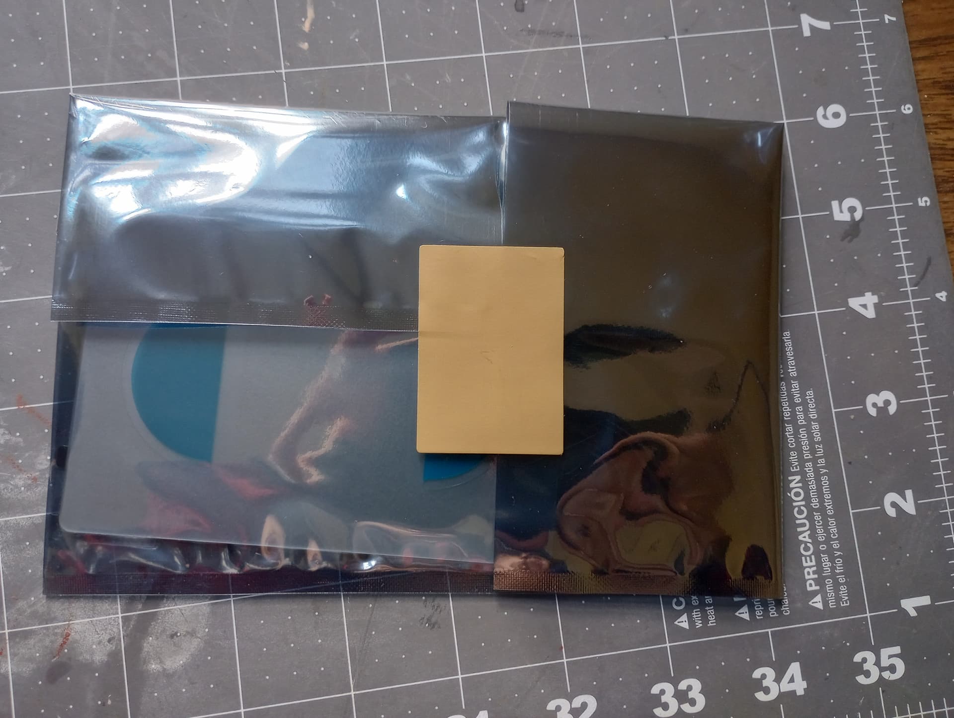

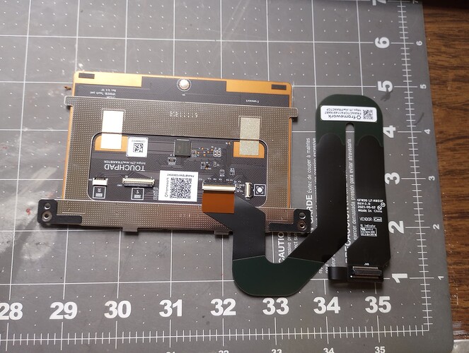

i just got the replacement touchpad. it does not come with a clicker, only the touchpad itself with the cable attached. it did fix the issue as far as my preliminary tests go. i just installed it 2 minutes ago. i’ll send pics of the package later so you can see what it looks like and i’ll be seeing about if i can return the old touchpad to get a refund on it. hopefully they’ll cover this under warranty. i did notice the rubber padding was centered correctly on both sides of this new touchpad whereas the old touchpad had it on the very bottom edge under where the left click would’ve been used, so i believe the original touchpad had a defective placement which i couldn’t permanently fix
edit: as promised, here’s photos of the replacement touchpad
