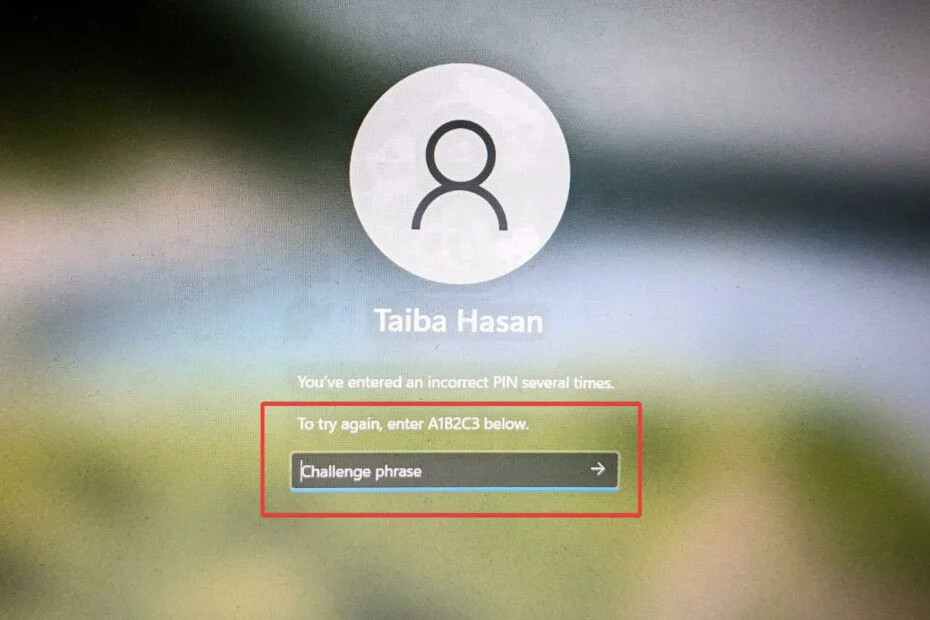

Google gives some results for a challenge phrase issue where it says “enter the A1B2C3”
is that what you’re seeing?

To be sure, the “challenge phrase” just asks for you to write the letters that it shows above.
For example, on the image shown here Starting screen - #8 by MJ1, you would enter “A1B2C3” as challenge phrase… Did this not work for you?

Now if it specifically says “enter the A1B2C3” that’s different. It seems to be a particular bug, I saw procedures that were supposed to fix that. You need to search for windows “challenge phrase” "A1B2C3”. Search link

Actually no. The “A1B2C3” issue seems to be a bug. Entering “A1B2C3” won’t work. Though this is just from me glancing over solutions for that issue.

Are you getting “enter the A1B2C3” or just regular a challenge phrase screen with no mention of “A1B2C3”?
