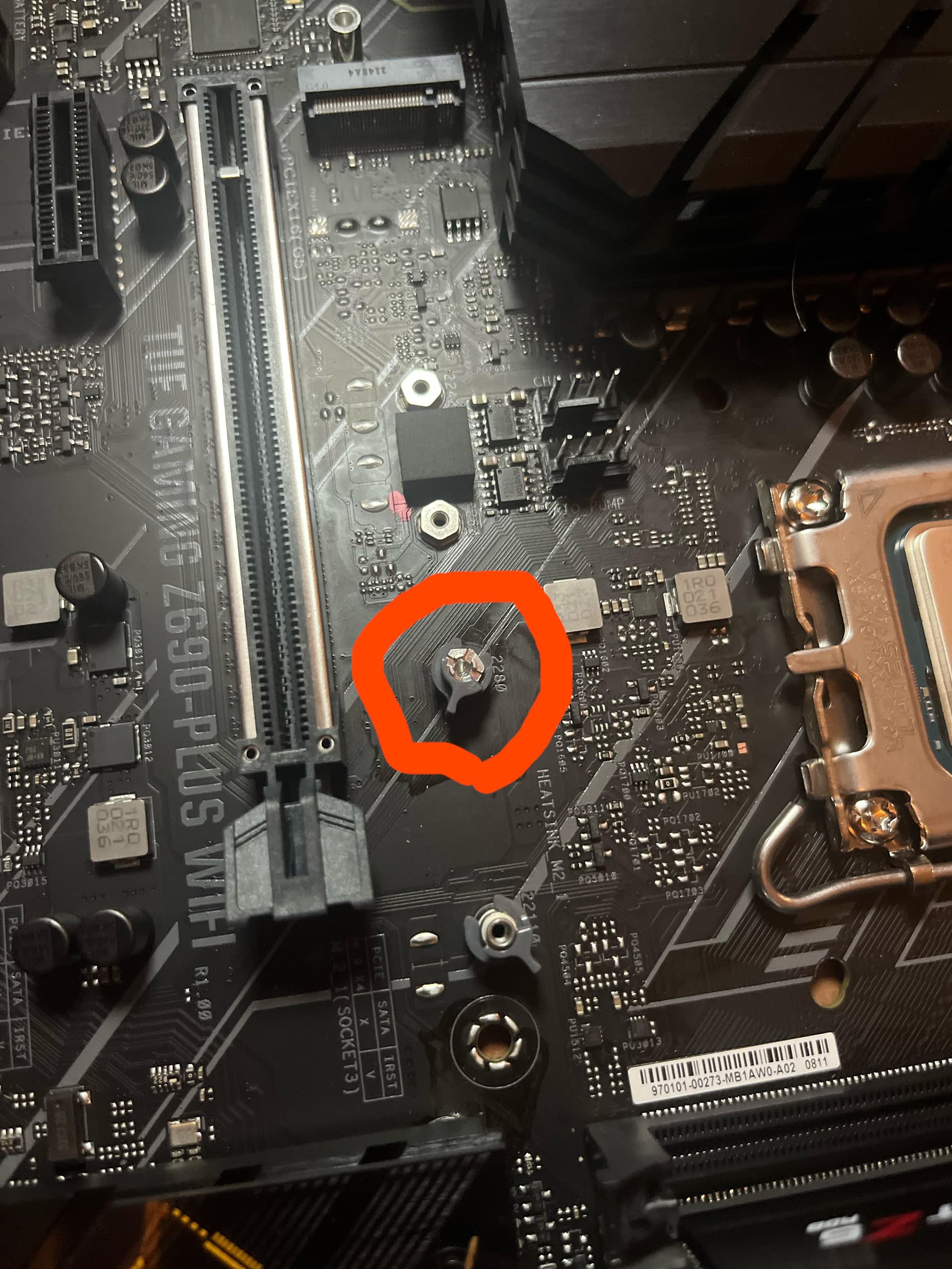

A better solution would be to do what some motherboard manufacturers do and make a pivotable cap like what ASUS puts on their motherboards. It just turns 180 degrees to lock the device in place. It is not like the drive needs to be held down with significant force. I can not imagine someone literally throwing around their laptop so much that it would pop free.
Here is a picture of what they look like:
https://www.reddit.com/r/pcmasterrace/comments/zjbqj4/what_is_this_plastic_thing_where_my_m2_ssd_has_to/#lightbox
A smaller solution might need to be developed for Framework or other laptop manufacturers. There might even be solutions already developed from other vendors; this is just one that I am aware of and have been impressed with.

I think it was on one of these threads that someone posted a link to a little plastic device for this purpose. It uses a keyhole shaped hole in the PCB and is locked with a quarter turn. I think it was in a thread about fitting m.2 drives in the GPU expansion bay area.
Personally I would much rather deal with the stripped SSD screw in mine over these things. I despise these mounting brackets for m.2s since to me it seems like there’s no guarantee it’s latched properly, and it feels like given how thin the actual spinny part is it’ll snap with even a tiny bit of force, not to mention pushing that against the SSD feels like it’s going to dig into the board and break it. All of this is from experience with my desktop having these mounting brackets for all 4 SSD slots.
