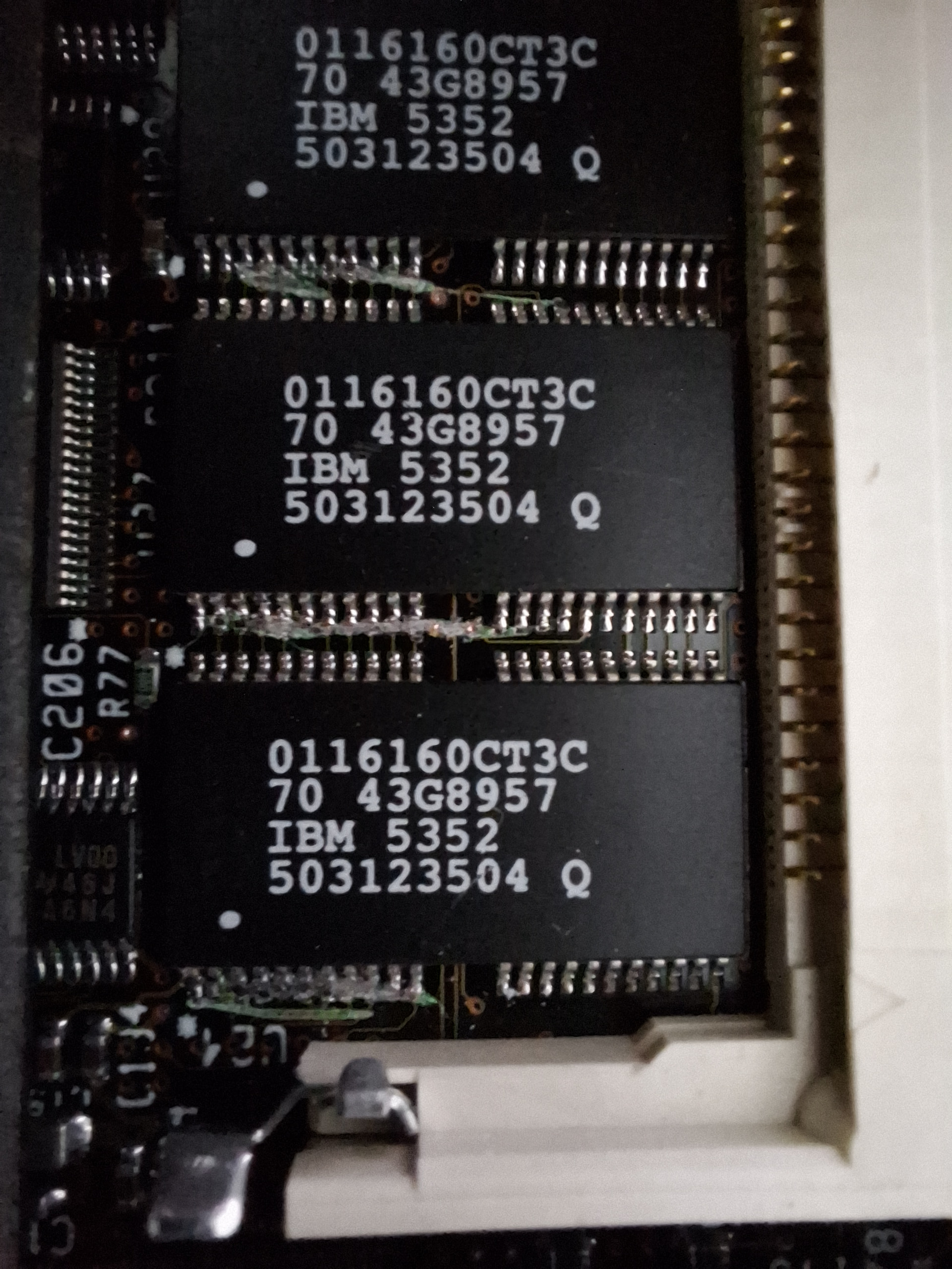

Hi Karl…great work! On the other hand… I recently purchased a thinkpad 701c… but terrible:
… some stupid person ruined the motherboard scrapping the memory chips pins and traces… maybe you still have the old motherboard of your 701c to sell ??? Pleaseeeeee?
Thankssss !!! Regards from Barcelona.
