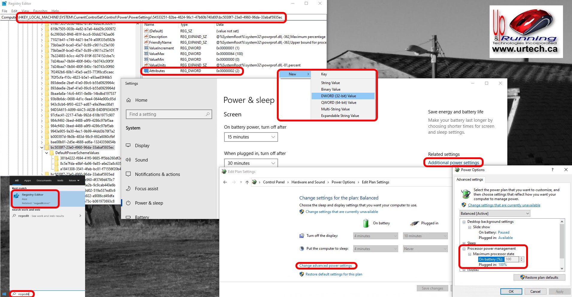

I have the issue that after 15 min of simple “office work” that my fan starts spinning. I tried to set that option of “maximum processor state” but in my framework (11th gen) the whole group “Processor power management” is missing! Any ideas?
Ah I figured it out, needed some registry tweaking to show the menu:
