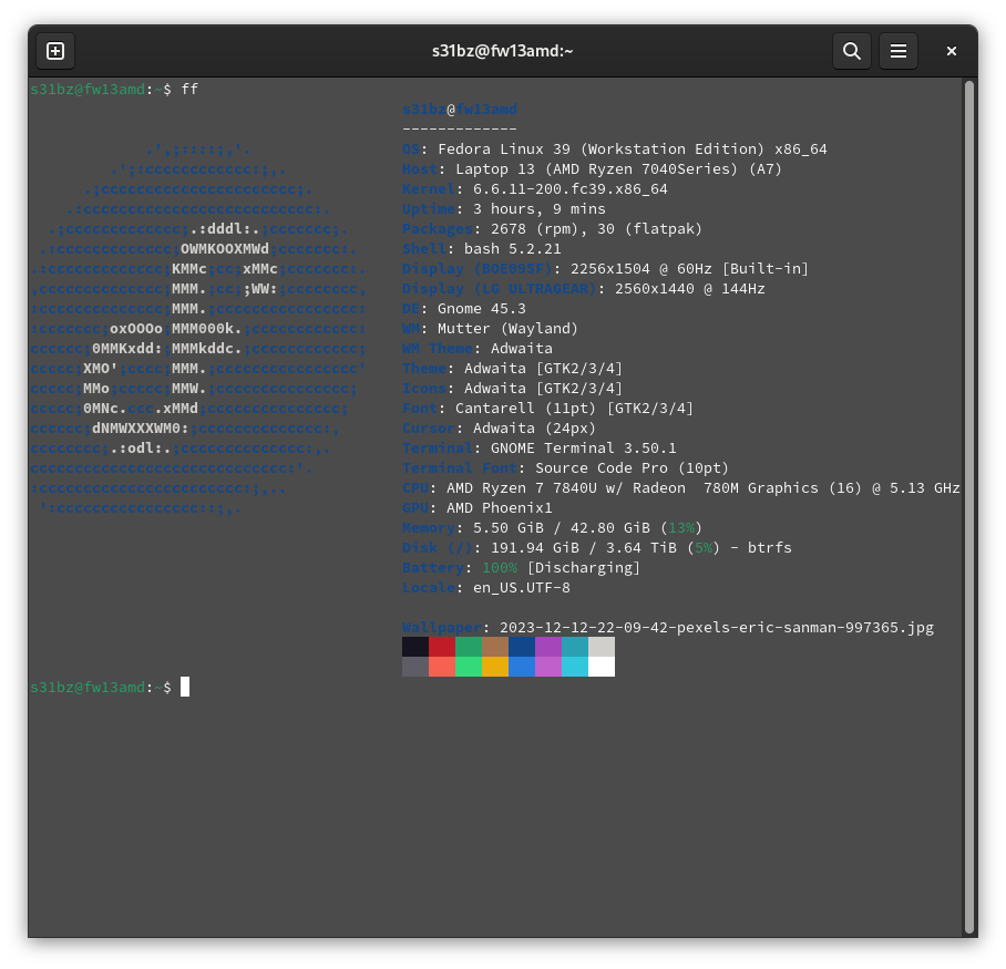

framework 13 AMD Ryzen 5 7640U
fedora 39 - Wayland - Kernel 6.6.9-200 - RPM Firefox 121.0
