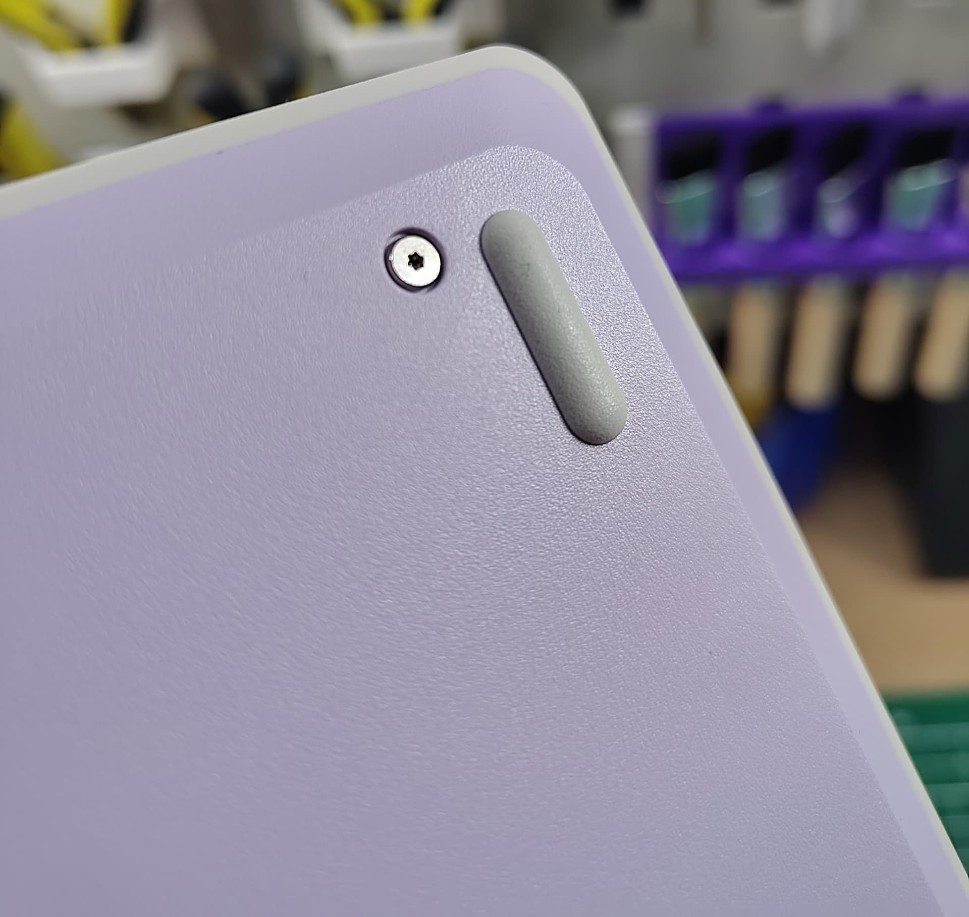

My lavender 12 has that around one of the screws also; I’ve had it a little over a week, so I sort of feel like it’s a moulding issue and not actually stress cracking. I’m no expert, of course.
Edit: I feel like I should mention this is very hard to see, and I wouldn’t have noticed without it being pointed out.
I think yours is on the opposite side (unless the photo is mirrored) but it does look very much similar to mine.
I agree it’s probably the molds in that case
Nope, photo isn’t mirrored.
That’s weird, Mine doesn’t have one on that side. :thinking:
They might have more than one mould; guessing though.

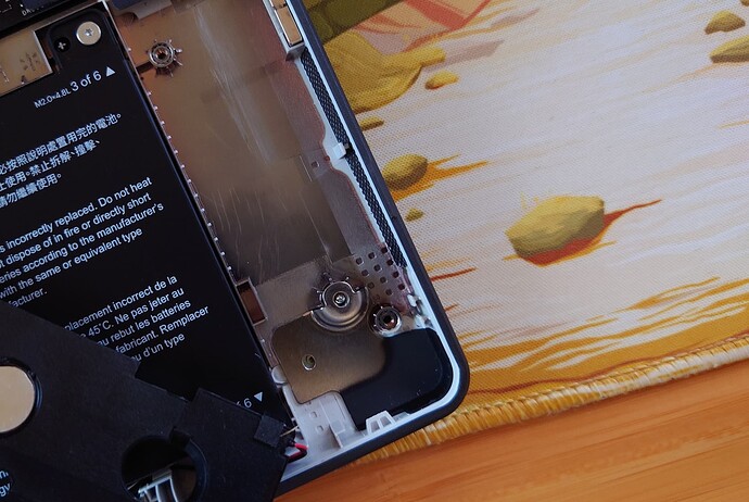

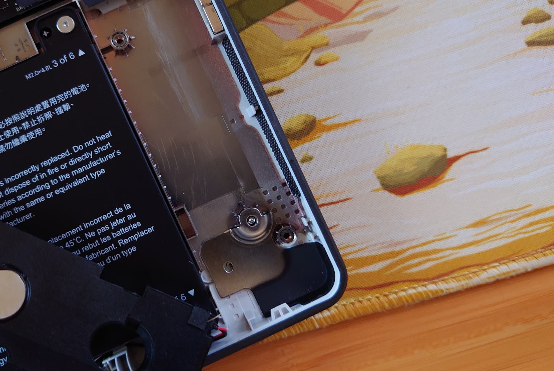

The thing is, while I can’t say for sure about the ones at the display hinges, the ones near the front screws are in just about the most rigid spot of the entire chassis. I can’t imagine that spot flexing enough to cause a crease/crack like that.
Here’s a pic of what mine looks like in that spot inside, with the speaker removed. There is a little metal plate, multiple re-enforcing ribs, plus the battery and the speaker are all right there, not to mention the vertical sides of the chassis. Even with almost everything removed, it is still pretty rigid at that spot.
I’m not even sure what kind of normal use would stress that spot over time enough to crease/crack the plastic.
Totally agree, no way the front is flexing enough to stress it.
I’m more worried about the ones near the hinges because those tend to actually bulge out and are much more pronounced on my laptop.
