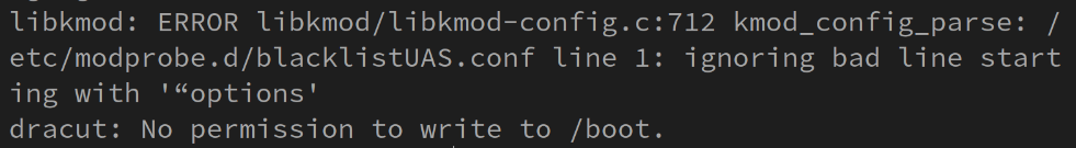

Hello @Aggraxis. As I am experiencing this hard freezing issue I followed the process you described here and all seemed to be going fine until I called dracut. This is what I see at that stage.
Perhaps I did something wrong?
Edit: I added sudo to the dracut command but the issue with ā€˜"options’ remains and it definitely hasn’t worked.
@ggg I didn’t follow the power saving guide. It seems to do this 'out of the box '.
@Greg_Stedman you seem to have a stray quotation character in your i915.conf at the beginning of the line. That’s what the error is telling you.
Thanks @Aggraxis. I have no idea where that stray quotation character is coming from. I can’t see it in Terminal and when I look at the i915.conf file itself in /etc/modprobe.d/ there is no visible quotation character either. Weird. I’ll keep trying but I’m a bit stumped.
@Greg_Stedman It appears the syntax error is in /etc/modprobe.d/blacklistUAS.conf file, not /etc/modprobe.d/i915.conf.
@Jason_H_Young thanks for catching that! I was still waking up when I saw the message the first time this morning. LOL!
@Aggraxis Anytime! If I had a nickel for every time things like that have caused me wasted hours at home & work, I would’ve been able to retire 10 years ago.
Ugh. Thanks @Jason_H_Young and @Aggraxis. I was fully awake and didn’t notice, so I have only myself to blame.
@Greg_Stedman no worries, friend! Let us know how things go!
