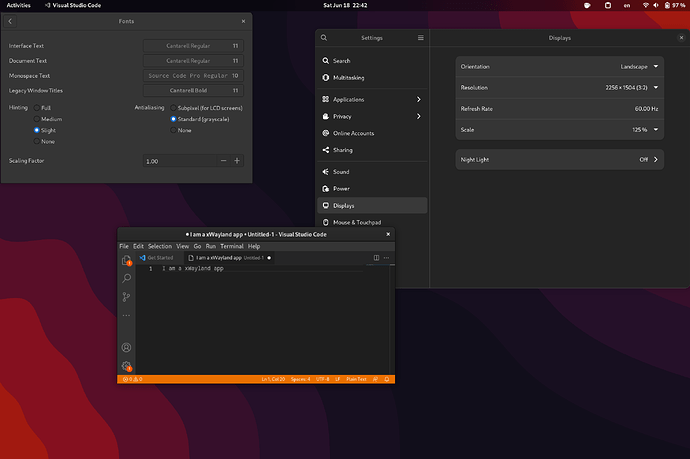

This is defulat size.
125% fractional scaling
100% scaling with 1.25 font scaling
Notice how the UI elements are just as large when using 125% scaling, but the text from VSCode is not blurry.
