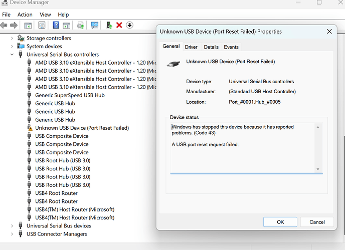

Unknown USB device error FW laptop 16?
I’ve had my framework 16 (with graphics module, running windows 11 23H2) for about a month now, no issues to report until just a few days ago where this error has shown up in my settings and device manager. My keyboard, trackpad and all my expansion cards work so I doubt it’s one of those. Whatever it is also periodically disconnects and reconnects at random (however this disconnecting and reconnecting only happens when I prop up the laptop at an angle on a stand and connect it to an external display, keyboard and mouse). Is there any solution to this issue?
I have had the same issue, nothing seems to not be working correctly. Sometimes when I boot the computer to Windows 11 the message comes up that a USB device that was previously connected failed to connect. I have tried disabling the device and enabling it in Windows and it remains the same.
I have a Framework 16 without the graphics module.
Updated to BIOS 3.03
Batch 6
Windows 11
64GB Ram
Samsung 990Pro 2TB
Numpad Module
I suspect others have had this same issue and maybe not said anything.
Framework Laptop 16 windows hardware
Same! Tried to reinstall BIOS and bundle didn’t work! Uninstall, reinstall, disable etc nothing worked.
