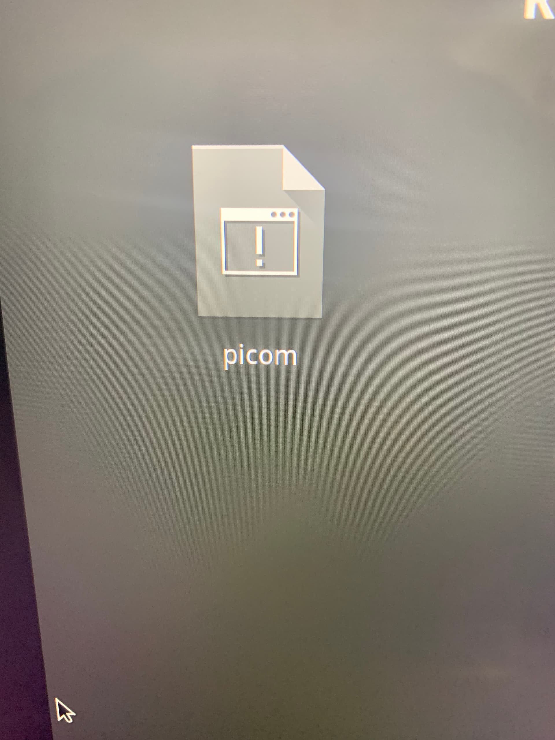

Out of curiosity how would one delete an icon in the Gnome display? Like when you hit the button that shows all your apps?
This might be a good start:
Entries in Gnome’s application menu come from “*.desktop” entries. If you remove the relevant file, the entry should disappear (on next startup?) However, usually the relevant files would be under control of your package manager, so you’d probably don’t want to remove those files manually. Better to uninstall the relevant application through the normal means.
