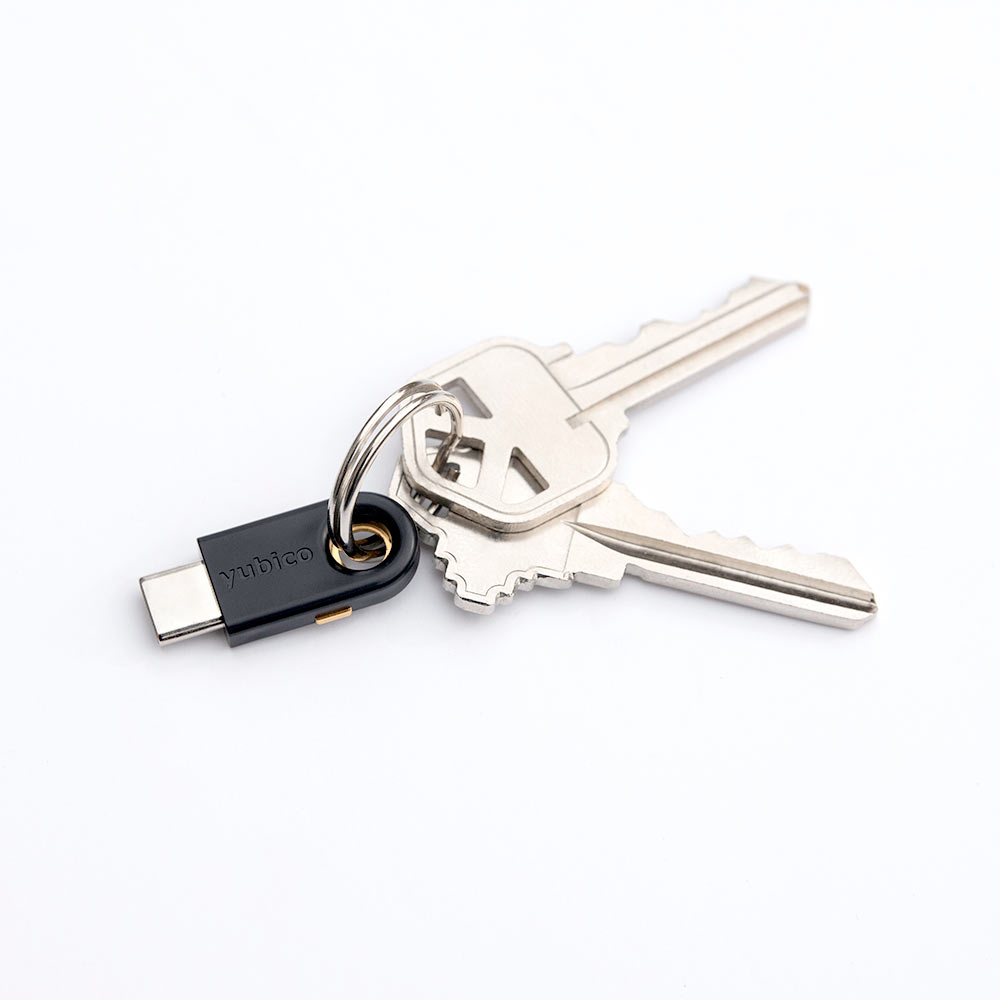

Some examples of the YubiKey 5c in USBC format:
For the most compact but arguably the hardest to remove:
