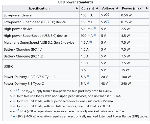

Each port can supply up to 3A, but only 2 ports at a time can do 3A and the other 2 do 1.5A, how are you getting these measurements and why do you think you cannot get more than 500mA, and what is the expected behavior?
500mA is the spec limit when the data lines are connected (i.e not shorted)
Heaps of devices use above the spec.

sure, and when something doesn’t work its the fault of the device for drawing more power than its allowed, not the source.
What do you make of this?
third line, 500mA. That’s the limit for pre-USB3 power and data. higher power (1.5A) is available by shorting the data lines.
